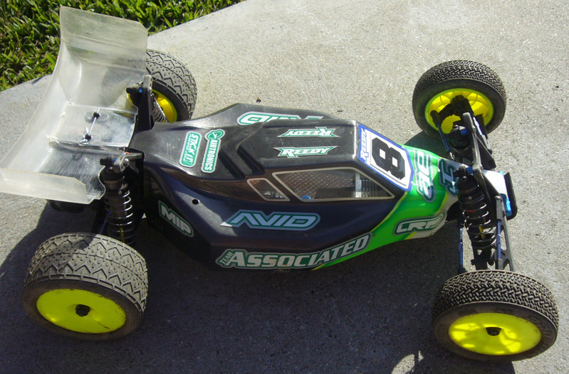

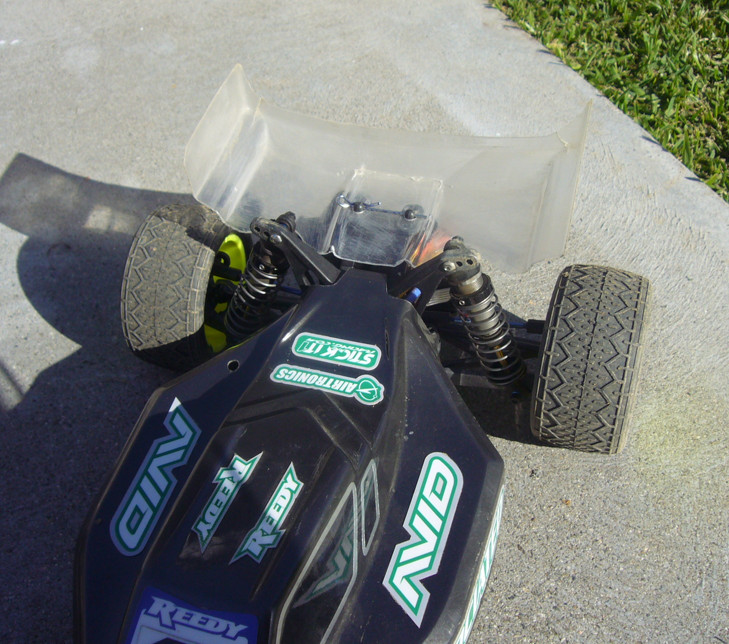

Here's some pics I snapped of my B4.1 WE. Sorry it's not perfectly clean...straight off the track from practice last week.
I am running pre-production spring cups and upper collar adapters. The upper adapters fit directly over the AE kit shock collars. If you want to run the inside hole in the front tower, you have to shave the tower, or space the shock top back.
