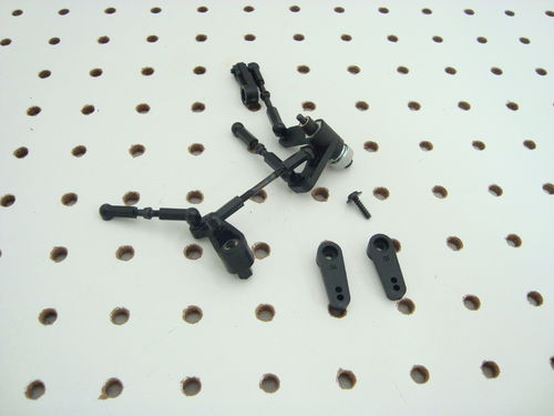

Parts -
One HPI 93317 (servo) Turnbuckle - this will replace the A186 Ackerman rod = the oem Ackerman rod has right hand threads on both sides / using the servo turnbuckle instead allows you to adjust the Ackerman link without removing it.
You'll need to cut the upper deck brace to access the new Ackerman turnbuckle.
One HPI 86195 Ball Studs
One HPI Z125 Ball Cups (and two Zip Lock Bag disks) or RPM 73375 Heavy Duty Ball Ends
One HPI 86190 Servo Saver Shaft
One HPI A181 Servo Pipe
One HPI 85097 Center post/Servo Horn/Steering Crank Set
One HPI A182 Servo Saver With Nut
One HPI B017 Bearings
Plumber's Teflon Tape
OR
Contact Anthony at ICB Hobbies www.icbhobbies.com/
He has a Buy It Now RC 'bone yard' on that left coast auction site & I was able to get the parts quite reasonably priced AND he ships FAST!!!
He lists the parts as HPI RACING SPRINT 2 SPORT FLUX STEERING BELL CRANK & 23 24 25 SERVO SAVER HORNS
