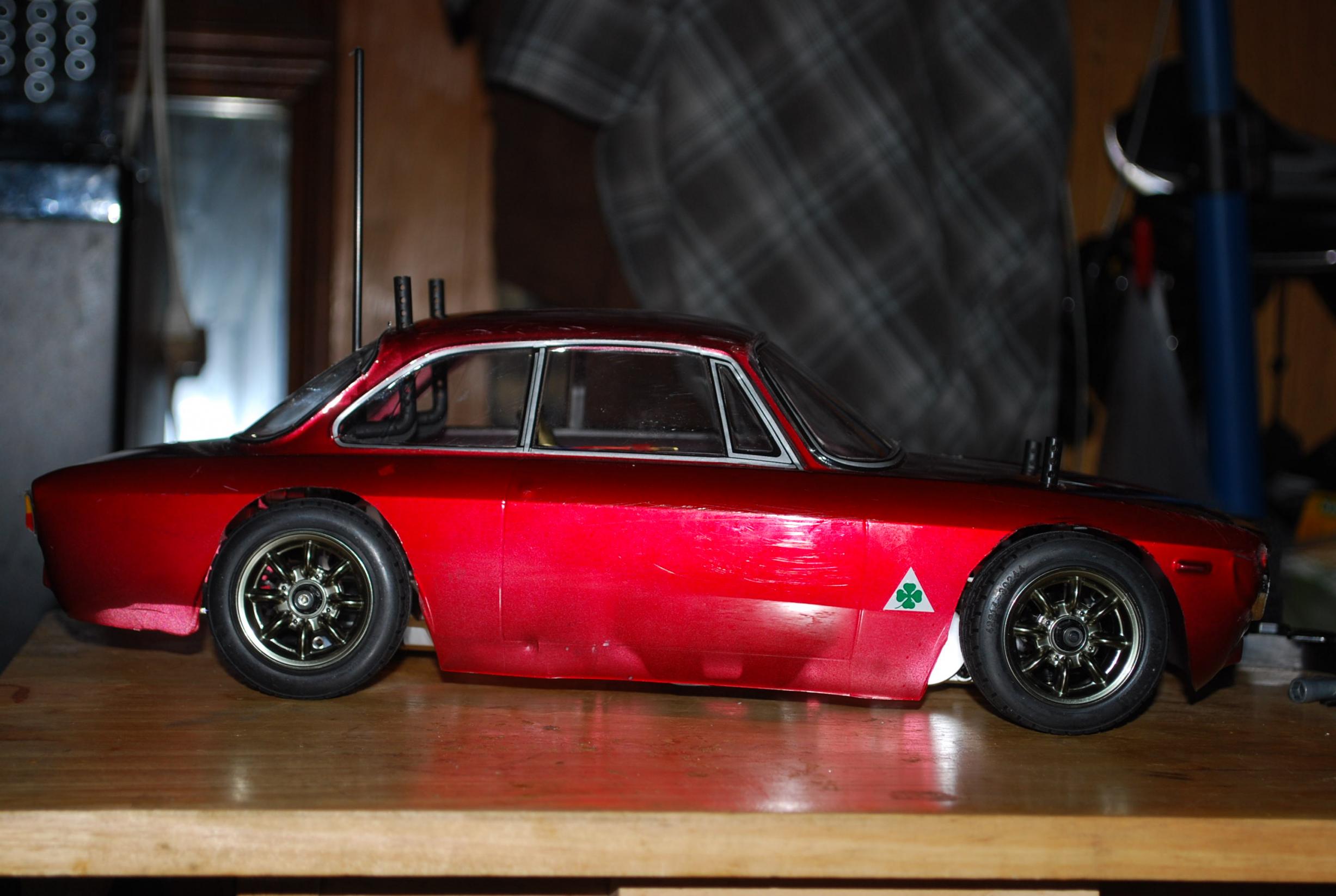

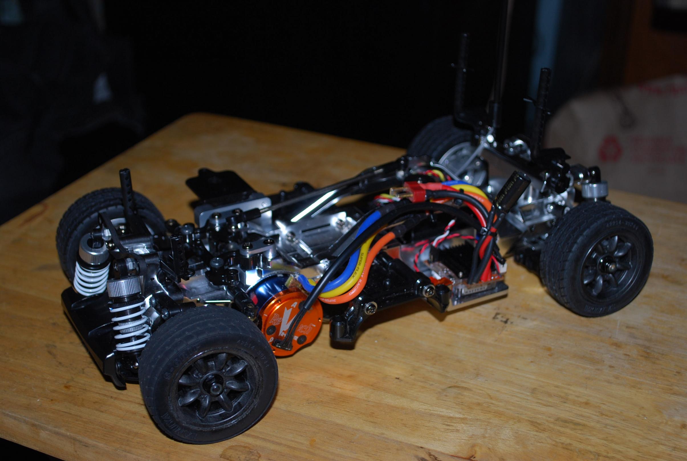

Here is my just finished M05 Pro build. My base set up is:
Suspension:
Front shocks 55wt/blue springs 3 hole piston
Rear shocks 40wt/yellow springs 3 hole piston
Height: front 5mm rear 6mm
Camber: rear +2
Tow: +1.5
Tires: any combination of S-Grips, Type A/soft and Type A/firm
Drive Train: TA03 Ball Diff, M03 CVDs
Motor: Revtech 17.5/20t pinion
Speedo: Novak Edge
Body: Alfa Romeo Giula (CRX on order)
I will test this weekend at Speedtechrc
