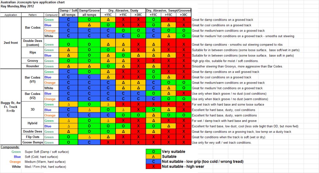

JConcepts has a large range of tyres and compounds to suit a very wide range of conditions. To help make racing more enjoyable and hopefully cheaper for you, I have created some charts to help you choose which tyre best suits your track conditions. This has been based on a significant amount of testing at a wide range of tracks and conditions, but each track has its own character so dont be afraid to experiment as well

The 3Ds are my new favourite tyre for typical Australian track conditions. They are a mix of a Bar Code style layout (good for hard base) but are constructed of pins and have pins between the bars (giving good traction in the dust). If you have a hard / abrasive track with a loose dust layer, give them a try. I think they could become an awesome control tyre
The Hybrids have a smaller pin design with a flat carcass and are suitable for tracks with a hard base and a light dust layer. They give excellent forward traction but a little less side traction than a DD. Use for a smooth track with a point and shoot layout when you want to let the rear slide a bit in the turns.
Main thing to remember is to match the compound to the temperature and track condition:
Green: Very soft, use in cold / damp condition
Blue: Soft, use in cold / swept condition
Orange: Med, use in warm / swept condition
White: Med/Firm, use in hot / swept condition.
