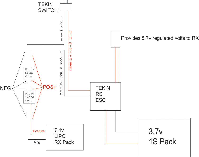

Originally Posted by wingracer
You will probably be fine going straight but if you want to be sure, you can wire the pack into the switch. It works great.
I was going to post the diagram for you but I had a crash the other day and now all my pics are missing
I gotcha both covered
Name:	Tekin 1S with 2s LiPo Rx pack inline with switch.jpg
