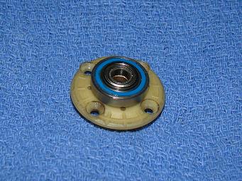

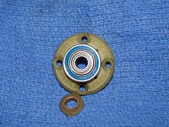

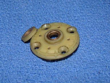

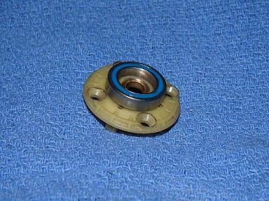

I think I may have found a way to fix wobbly diffs. You cut down where the 10x16x4 bearing rides to about 1.25mm tall, then you can place a 5x10x3 bearing(AE91156) inside the other bearing for the outdrives to ride in.
Attachment 856485
Attachment 856486
Attachment 856487
Attachment 856488
BRILLIANT, i feel pretty dumb for not figuring that one out!!
