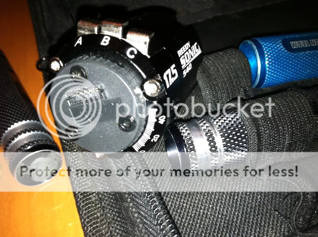

I recently bought a new reedy sonic. It appears to be a newer version. It has the numbers as shown in a previous pic. My question is. Are these made differently? There is no way the timing mark will go all the way to the screw.
With the new timing scale you would never turn this motor to the screw.
You should never go above the end of the scale. I would recommend starting at 40 for no timing and adjust from there. If you are running in a boosted class or modified I would recommend starting at 20.
AGAIN DO NOT RUN THE NEW VERSION MOTORS AT THE SCREW!
