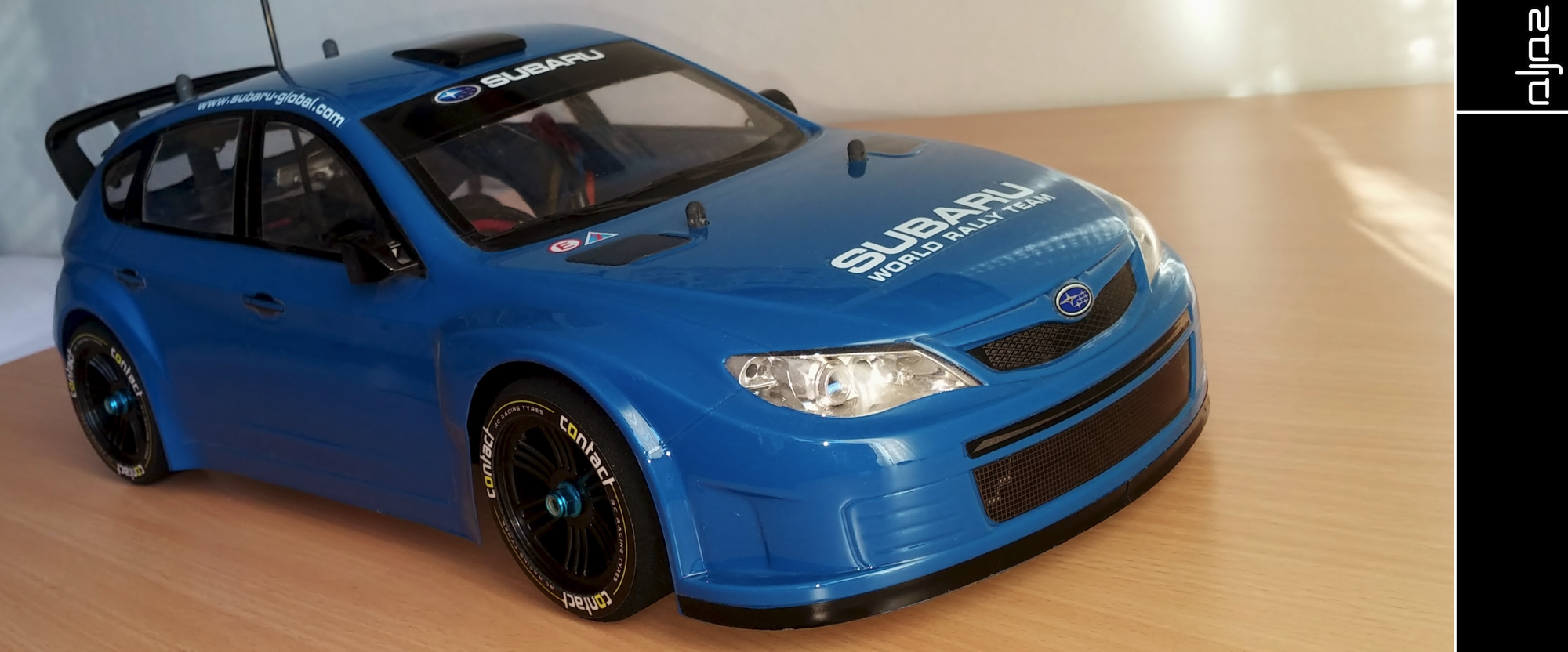

Default Contact tyres
Hello!
I decided to test foam Contact tires on tarmac surface, the local supplier recomended to use hardness 37Sh JAP Carbon J13773, dimensiones of tires 26mm in wide and 64mm in outside diameter. Looks great on my rally version of Tamiya TA07 pro chassis. Has anyone already use mentioned tires, maybe some opinion?
Thank you.
tamiya wrc is offline
