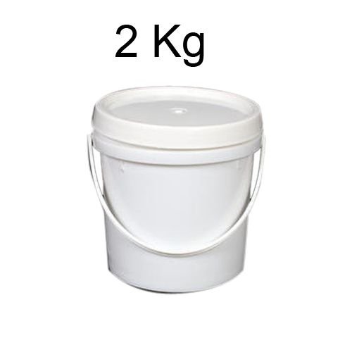

Should have included this:
I use a 2.5l container for both. So I can have multiple sets of wheels in the acetone. Basically as many as I can fit in the container.
I put a slightly smaller container (ie 2l) with holes in the 2.5l and put the wheels in that. So to remove the wheels I just lift the smaller container with the wheels out, the holes in it let the acetone drain into the bigger tub.
Like this:
I did before put the wheel straight in to the 2.5l container. But always has difficulty getting the wheels out.
MiCk B. :-)
