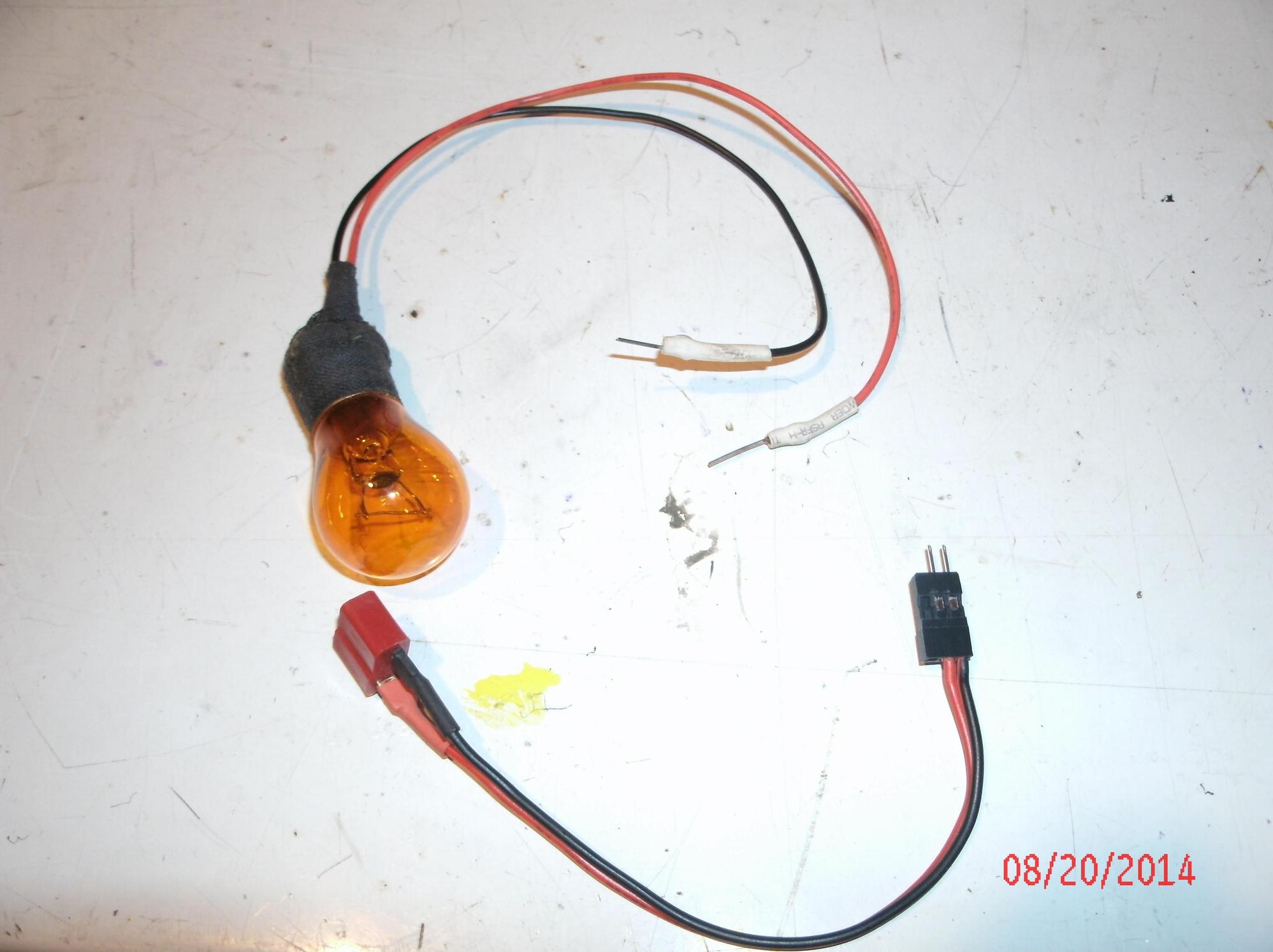

make 1 of these it will help charge only that low cell. helped me with a stubborn low cell of 10. you charge 1 cell on charge and fin what 2 balance wires have the low cell. one can charge a few amps unlike a balance charge or discharge...

i also have a up to 10amps charge thru balance plug only charge .. was gonna try to inject some humor wkhtg.

1/2 amp no wonder its taking you 5 hours..reset time limit to a great amount and use more than a 1/2 on that low cell.. that single cell lead i posted will take more than a 1/2 amp .
