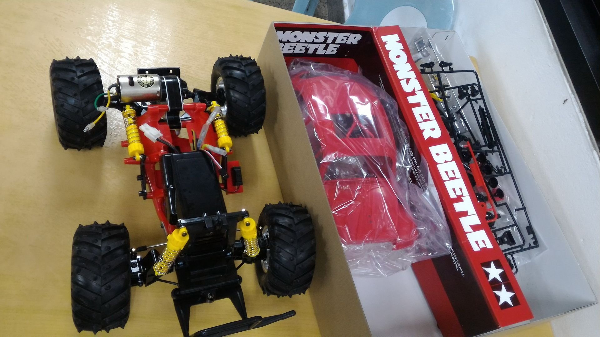

Re-re monster Beetle kit already comes with ESC and 540 brushed motor in the package. Whats left you'll have to purchase 2 channel radio, Futaba S3003 size servo and 2s lipo battery pack. Here's mine.
