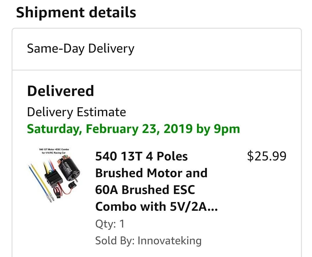

Anywho, I took it outside anyway, plugged in a 3s lipo and ran it in the low setting and the ESC exploded after the car got in the grass. I guess it couldn't handle the torque. Or the battery current (though the specs says it works with 3s). That's what I get for being cheap.
So no one makes the same mistake as I, here's what I bought that exploded (the ESC):
540 13T 4 Poles Brushed Motor and... https://www.amazon.com/dp/B07JQQHKYV?ref=ppx_pop_mob_ap_share

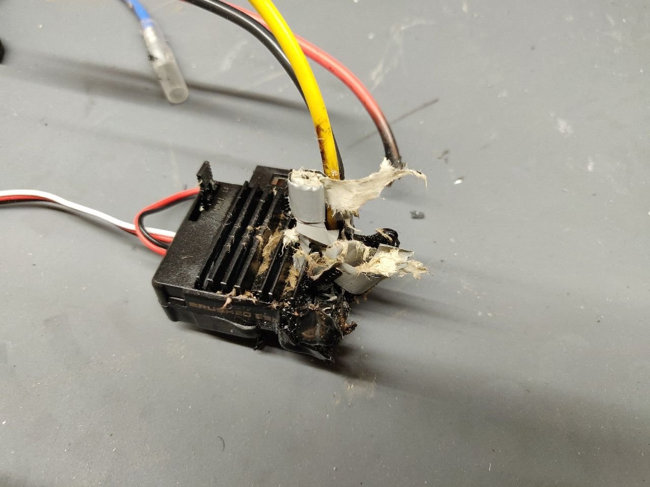

The ESC wasn't a GoolRC either (pictured below), I don't know the brand since it's not on Amazon's site anymore. It smoked then popped (pictured below)... so, I'm not sure if that's frying or exploding. I initially thought it was the lipo battery popping, so I assumed explosion.

I just need electrical tape to cover that hole and it'll be RTR again.
anuvanoob is offline

The esc you blew up auto throttle calibrates no programming the esc to recognize throttle trigger positions does it automatically (most cheap stuff Goolrc etc. brushed or brushless is like that).
Just because a esc says it can run 3s doesn't mean you can run any old motor on 3s there is a motor turn and size limit (kv and size of motor for brushless also).
Also don't know what you put this in but you don't run a 13t 540 brushed motor on 3s it better be one lightweight RC and not ran in grass.
What battery are you using? Using a under rated 3s battery can blow (explode) caps on a esc.

Yep the cap (capacitor) exploded.

The Goolrc escs plus the look a-likes are very hit and miss (reliability) not waterproofed very well if at all. The motors are not that bad it's the escs that can stink. Run that 4300kv 60a on 2s and not through any water you might be fine. But your pushing your luck even more running 3s and through any water. All the cheap escs I splash proof/ waterproof myself.
The stuff is cheap but you must use a little common sense don't believe everything that is written spec wise everything has it's limit especially the cheap stuff.
