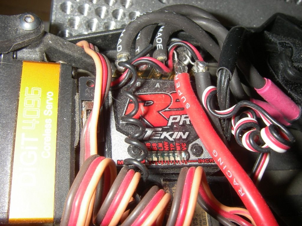

I am building a 4x4 10th scale buggy will this rs pro work with a 6.5 motor on 2 c lipo Thanks
rspro
chucko is offline
Old 07-11-2019, 01:31 PM
  #97
fievel's Avatar
Join Date: Sep 2008
Location: Rochester Mi
Posts: 889
The RS Pro may get too hot when running a 6.5T in a 4wd buggy. You might be able to get away with it if the track is indoors and small. Tekin recommends the RSX Pro for mod 4wd.
chucko likes this.
