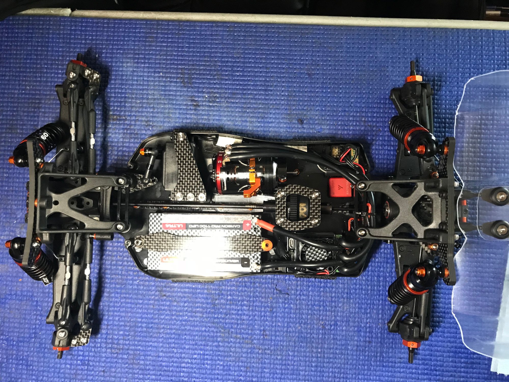

Join Date: Mar 2018
Posts: 13
So i also jumped into the HMX 10 modified. Installed it in my yokomo yz4sf using 5.5 orion motor mayfield 2017 ifmar clone. First time i used my phone to plug into the ESC to calibrate a puff of smoke and i could smell burning. Could not unplug it fast enough. A day later before sending it back to Horizon hobbies i tried again with my laptop using usb to micro cord still couldnt connect. Found my old blackberry usb to micro usb cable and was connected on COM3 after installing the FTDI drivers. I had to have radio on battery on car plugged in and then connected usb cable ESC lit up then power on my buggy and could connect and configure updated firmware 1.4 and using mayfield settings. Going to track today to hopefully race and test new car and tune. Will bring my notebook.
Hope this helps you guys. BTW i tried with a note8 using usb type C to mini usb first(smoke followed).
