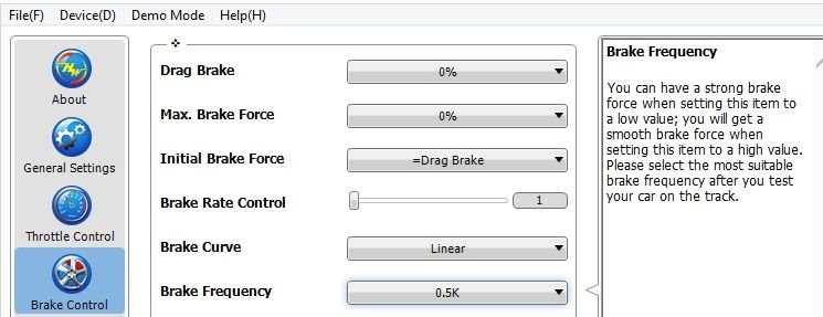

Have you tried messing with the brake frequency? Anyone know how this affects braking? tks
Brake frequency affects the feel and strength of the braking. Higher frequency gives a softer/weaker feel and lower frequency gives harder/stronger feel.
If you open the software on a PC there are helpers that explain what each setting does.

I never use the software....always the program box.....now I will use the software,,,,thanks Much
