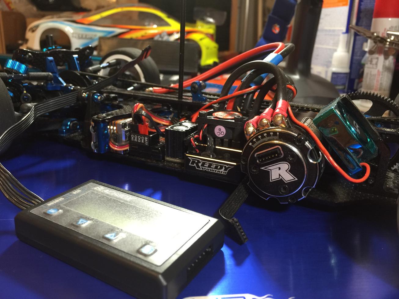

After I set up my center on the steering (servo), when I was trying to get the car to track straight, at full throttle the steering seems to have a mind of its own! It will start twitching to either side, that is without touching the steering. I have a 1/8th Vorza 6s w/Castle Cap Pack that is setup for speed runs and have a Savox servo on that with the same rx. I have read and heard that Savox servos are power hungry, so I made sure to set the internal BEC on the Blackbox @6.0v, which is what the specs for the servo say, but this thing is possessed!! :rolleyes:
Should I set the BEC to a higher voltage? or just get a different servo? or am I missing something that's right under my nose?!?!
Thanks in advance for any help or suggestions!
P.S. - I have pics I can upload of the car if that will help, just need to downsize them, files are to large.
tony_italia 10-02-2015 03:54 PM
3 Attachment(s)
Attachment 1320744
Attachment 1320745
Attachment 1320746
