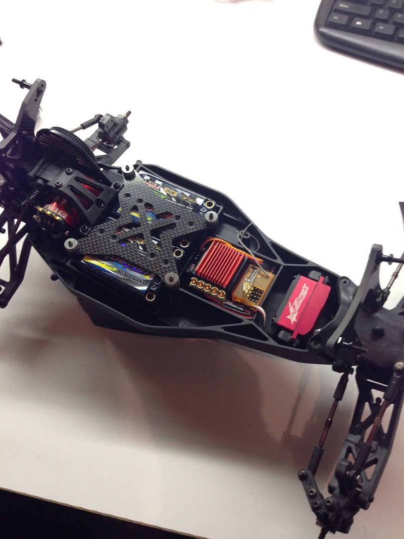

here is my 2wd serpent build
Full track star setup running v2 120esc. V2 7.5 motor this thing is so smooth makes driving 2wd a lot easier and faster Laps
Full track star set running v2 120esc. V2 7.5 motor this thing is so smooth makes driving 2wd ally easier and faster Laps
IMG (for forums, boards)
No images appearing benji lee
f
Sweet car. What receiver is that? Have you run the 1st version 120A esc? I'm curious as to what's different and how people like it. I just put the 1st one in my T4 the other day. Very nice, I took out an orion R10 that needs sent in for repair.
The receiver is the turnigy Orange series for spectrum dsm2 they are like $14 hehe I've raced with them for years
I also run the v1 it's also gold , one of my favourite functions with both v1 and v2. Is the turn off ---- just finish your run hold the trigger to brake for 4-5 sec and boom the car is turned off ✌️
The v2 esc is slightly smaller
Cheers
