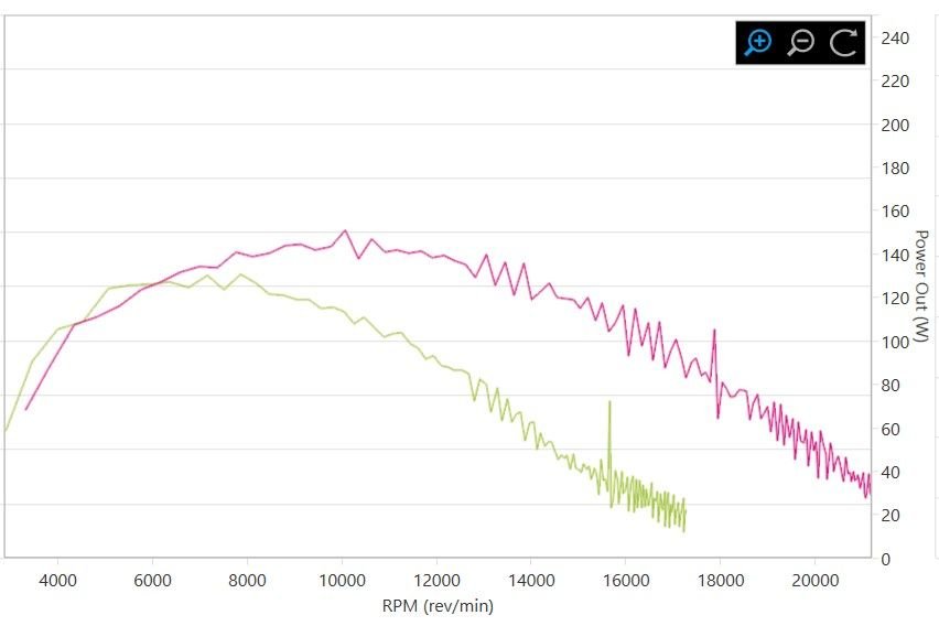

Pretty sure that's still the V1 motor. If you grind off the sensor board tabs so you can rotate it more to get more advance, you can get a little more performance out of it. But compared to a modern 21.5t motor, it's not even close. Trackstar vs Fantom 21.5t Minipro dyno run. Guess which one is the Fantom.

Welp, looks like it's time for a motor upgrade! That difference is HUGE.
Since you have a dyno, have you noticed much difference between that Fantom, and others of a similarly modern vintage? Or even better - Against a spec USGT motor
I wish dyno data like this was more widely available, it'd help separate true value from snake oil so much more easily
