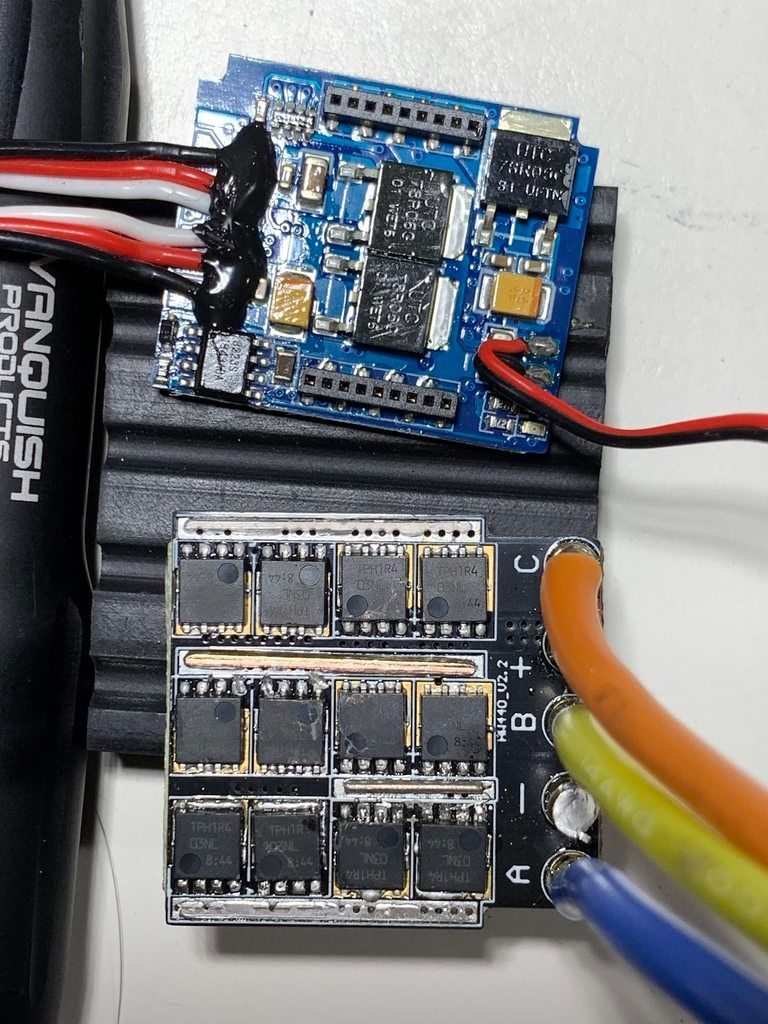

Someone at the track told me the its the caps that go first and if i was quick enough? Im leaning more towards its roasted tho. Im worried to hook my programmer up in case it fries it too, was wondering if any others have had success in bringing one back. I do see a single resistor that doesnt look happy on cap pack, but doesnt seem damaged enough to account for the amount of smoke.
Oh well, lesson learned i spose. Glad it wasnt my spendy esc.
The capacitors and the FETs are what normally blows. It's unlikely it'll kill your programmer card, but if a FET is damaged, no amount of resetting the firmware will help.
I decided to pull it apart for fun to see if I could spot any damage. Not seeing a whole lot but maybe those bottom two right toshiba mosfets do appear to have some solder melted? Link to original full size.

Solder is melted and shorted out the FETs in the above pic WOW! I wonder if inferior solder is the culprit for so many XR10pro G2 going bad? Curious to see if HW says user error on your warranty claim,it is one of their most common replies
