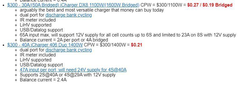

I've updated my comparison between the 406 and DX8 and it's really comparing apples to oranges
It really comes down to whether or not 30A is sufficient or if you want to charge at 40A or 50A bridged and things get dicey with how to calculate the CPW which is important to me in deciding which charger makes a better buy:
For a true 2 port charger then the CPW for the 406 makes a better buy for what I would be using the charger for in my case.
