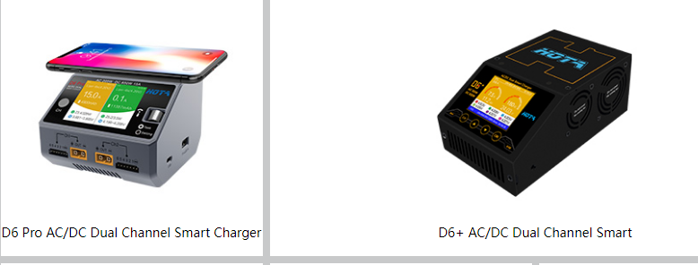

Pretty good specs on the D6 Pro, and the D6+ chargers.
I had bought the D6 (non powered) because I already had a power supply. I pretty much love it. When I went shopping for a new charger, it was the balance current spec that I paid close attention to. The Hota chargers had the highest balance current spec that I could find, and that fit my budget.

Thanks for the recommendation and explanation as to why it was the choice for you. After looking at all the suggestions posted here and like ones I found while searching, I have a D6 on the way.
