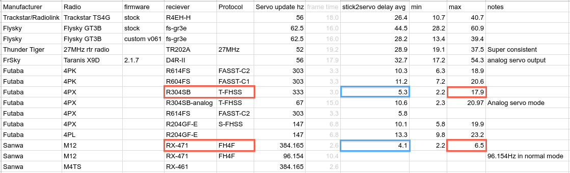

To make it black and white, if you aren't going to utilise the fastest response mode on either set, then you're minimising the benefit of your upgrade.
If I were making this choice myself, I'd only choose the 4PM if I was going to get the R334SBS (for my primary car at least), as well as the Futaba SR servos so that I could actually enable and utilise the SR mode. I wouldn't just assume that the "normal" modes are particularly fast, compared to the Flysky for sure, but compared to the competition at the same pricepoint, no.
Regarding latency, there are numerous people here who convert the servo update/refresh rate (in Hz) into a latency value and pass it off as system latency, which is very misleading and not what latency really is. If you read the thread I linked by condac and read his posts deeper into the thread, it helps explain more clearly. Basically, you have a system latency between the TX input signal (your hands) and RX output signal (to the servo), and then another time period for the RX output to become a servo output. Condac's stick-to-servo numbers are a total value, the important number.
As I said, Futaba have been lagging behind Sanwa for quite some time in actual TX-to-RX latency. The latest version may be better, but there is no 3rd party data - until someone like condac measures a 7PX and 4PM, you just don't know. I would assume if you buy all the parts to enable SR mode correctly, then the response will be very good - but even that's an assumption and nothing more.
If you choose the MT-S, there are plenty of other compatible RXs including genuine (471, 472, 481, 482 - the 47x have small antenna wires while the 48x don't, the xx2 signifies telemetry) and aftermarket options which you can search here for. I'd use the included 482 in your primary race vehicle and cheaper ones elsewhere. The benefit of the Sanwa regarding response is that there's 3rd party verified data on the M12/S and MT-4S, and the MT-S in SHR mode should (according to Nezil) match the MT-4S in SHR mode.
Re: Futaba latency being "relatively fast outside of SR mode", my answer is no, but for you maybe it'll still be pretty good. Honestly, in my book the jury is out even with SR mode. The drag on Futaba gear is their "worst case" RX-to-TX latency has for a long time been worse than Sanwa. I'd want to see a significant (verified) improvement there before buying their new gear. Check out condac's thread, he also has more posts elsewhere on the topic including histograms showing the data spread, if you're interested in this stuff it's eye opening. The max column using R304SB shows what I'm talking about.
Originally Posted by condac View Post
But looking at what happens and how fast it does things it is clear that update rate is not everything, from the time you move the steering until the correct signal is at the servo it have already sent 2-5 updates that are wrong until it have the latest signal. So Futaba have alot of room for improvement here, and other radio manufactures might do things quicker.
