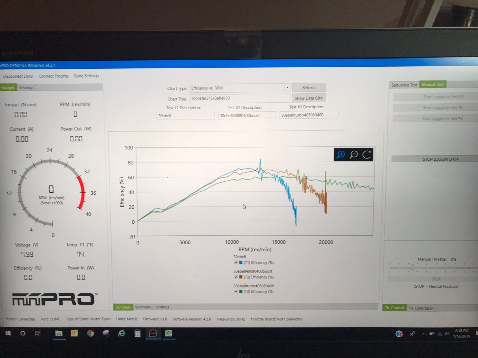

Here is something very interesting. I set the end bell to maximum torque down low and then i use boost from that point on. About half way up efficiency falls on its face so the boost if set to widen that curve. A few guys have talked about blending curves. This is a pretty radical blend.

thanks for the info. i start by plotting end bell at peak torque and efficiency for lower rpm. Step 2 is to launch boost off of the end bell peak torque. I think there is a picture here for the 215 and I have it for the 17.5 just didnt put it up. Iíll put that blended curve up after I find the optimal mid point based on the thermals that come out of the track for the 17.5. its already here for the 21.5.
But I figured out the ratios sanwa is using so i tried to see how low I could get the torque in the curve. its ludicrous. its a massive bump down low. When I bump it that low it carries it through rpms better than it does if I started the bump later. its something to investigate and interesting. with the power opening up (and efficiency following) its really got me thinking that if i can keep that (5k) notch out of the operating range for areas that need smooth acceleration a major gear change might be in order. On the 215 the standard deviation was like 2250 rpm. If the stuff outside of the standard deviation is in non-important parts of the track centering the power on this crazy curve might be ok.
I was showing off a little when I made that efficiency curve. if you look close you can see how tight the intersects are of a massive change in torque.

i previously calculated the torque and rpm I needed to stay under the max temp I use for the motor. 72c was the specific number everything stabilized at on track in practice laps. I had a 25 lap race this weekend (5minutes) and hit the hard limit for temp on the 2nd to last lap and lost 3rd place. I guess practice is different than a race. The 17.5 came off at 43c but i had worked the the motor to be controllable because letting it do what it does was too much for me and I placed well so more practice is the focus.
the 21.5 is pushed about as hard as a 200 watt motor can be pushed and if i push it less its boring. The simple answer is change the fdr or back off the timing or...this is a very tight track so heat is coming from the accelerations and the setup will be happier with it being more efficient during acceleration so i moved the centerpoint of the efficiency curve rather than torque curve over the average acceleration rpm. It doesnt start from zero so ...
i probably should have stayed true to that concept but i couldnt help myself and added something on top. i moved the centerpoint of the efficiciency curve by setting the end bell to 30 degrees instead of 40 or 50. This took the motor to 70% efficient through those rpms and the rise in torque actually gets me more acceleration torque. As predicted efficiency nose dives right after peak and I need 3500 rpms more at something equal to or better than the 60% I had. i triggered boost at the falling slope and it extended the curve out the way I wanted and should keep the motor temp cooler. It barely got warm on the dyno which is a significant improvement. i have almost equal torque/rpms and 10-15 percent more efficiency. So then i wanted to give myself the opportunity to screw it all up and added turbo. The idea is that I will stay out of full throttle at max rpm. The following dyno log is all 3 conditions. Straight end bell..boost to about 50 and then turbo.

i aligned the neutral plane by hand but I suspect the Sanwa esc is managing it. In practice my 215 was faster than 17.5 in the straights and smoother in the curves. I can take the old numbers and back off of them a little. Thatís essentially what I did with the mid level curve.
i wanted people to catch a few things and talk about them but itís hidden in the details so I will just identify them.
if you take your timing from 30 to 40 to 50 you are effectively increasing your kv. You are moving the power to the right which increases your rpm. You lose acceleration torque or efficiency at the low rpm to extend your max rpm. This is a good idea if you are stuffing in the straights. Bad idea if you are losing car lengths in acceleration parts of the track.
i think you can apply this to your sky rc analyzer. If your timing tests are at 10k and torque and current are assumed equal you can move the meat of the curve by moving the current above or below the test rpm to align the curve to what you are missing on the track.
in other words there is a kv and current curve for each 0-max rpm run at a given end bell value. If you know your max rpm for a track should be 16k and your average rpm is 11k use the gearing and timing to get the rpm aligned and torque will be as good as it gets without taking away your low rpm acceleration.

Based on the graphs, how do you know that the motor is in the neutral pane? What do you look for?
