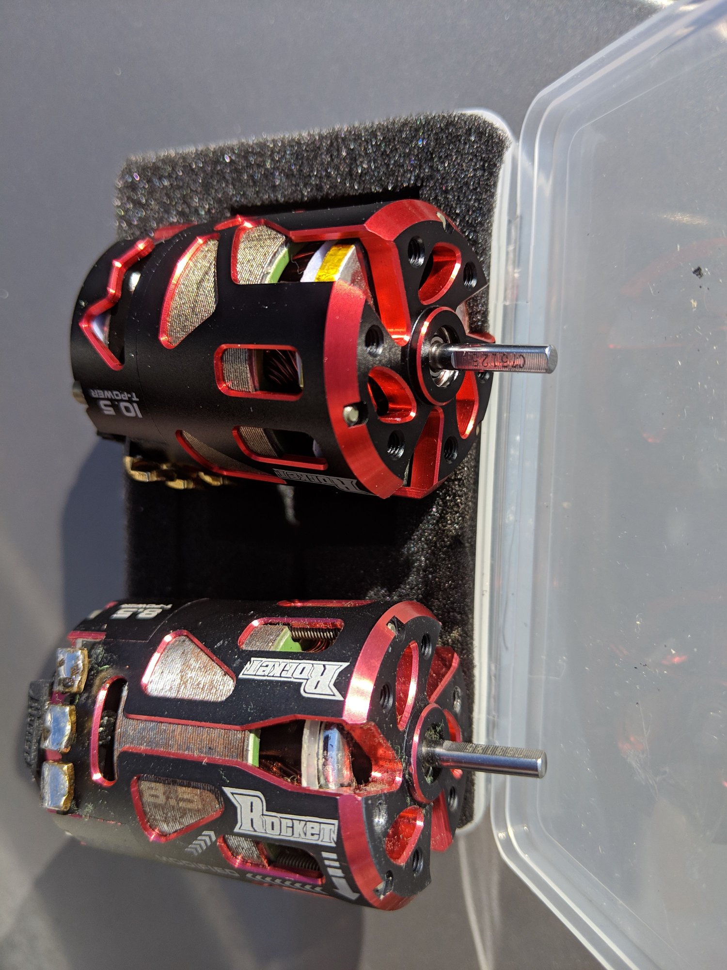

Guys you need to get your motors from the members here that are selling them! Look at the difference between the 10.5 I got from mixedguy (TOP) compared to the 8.5 I got on Amazon (bottom) because I needed a mod motor quick. Definitely fresher motors coming from our rctech buddies!
PS thanks mixedguy for the sweet motor 😁

that motor was sold to you as "new"? it's clearly used. solder on the tabs, carpet fiber everywhere. if that is right out of the box, i'd contact amazon and get your money back.

Sorry for the confusion on that. I ran one race day on the 8.5 that's why it's soldered. It was too much for SCT. But both motors were bought only a few weeks apart. I was just referring to the difference in the fresh color of the motor I got from mixedguy. The other motor from Amazon is a little dull and already has some tarnish on the stator. I didn't notice the difference untill I got a fresh motor

Hey Robby, Sucks that you had a bad experience. The beauty of Amazon is their customer service/return policy. send it back if it is a bad product.
Glad Mixedguy was able to help you out.
I recommend buying from a known source such as me or MixedGuy. but I would argue that not all of Amazon is bad. I sell motors on here and my website (Surpassracing.com) but I also sell on Amazon and Ebay. My Motors and descriptions are branded on Amazon as Surpassracing.com and ship from the USA.
BTW - I know you didn't buy that one from me( I dont have any mod motors in yet)
