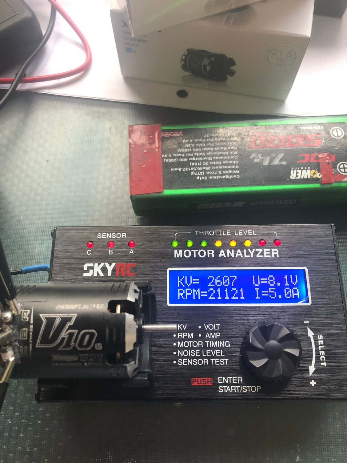

My old well used 17.5

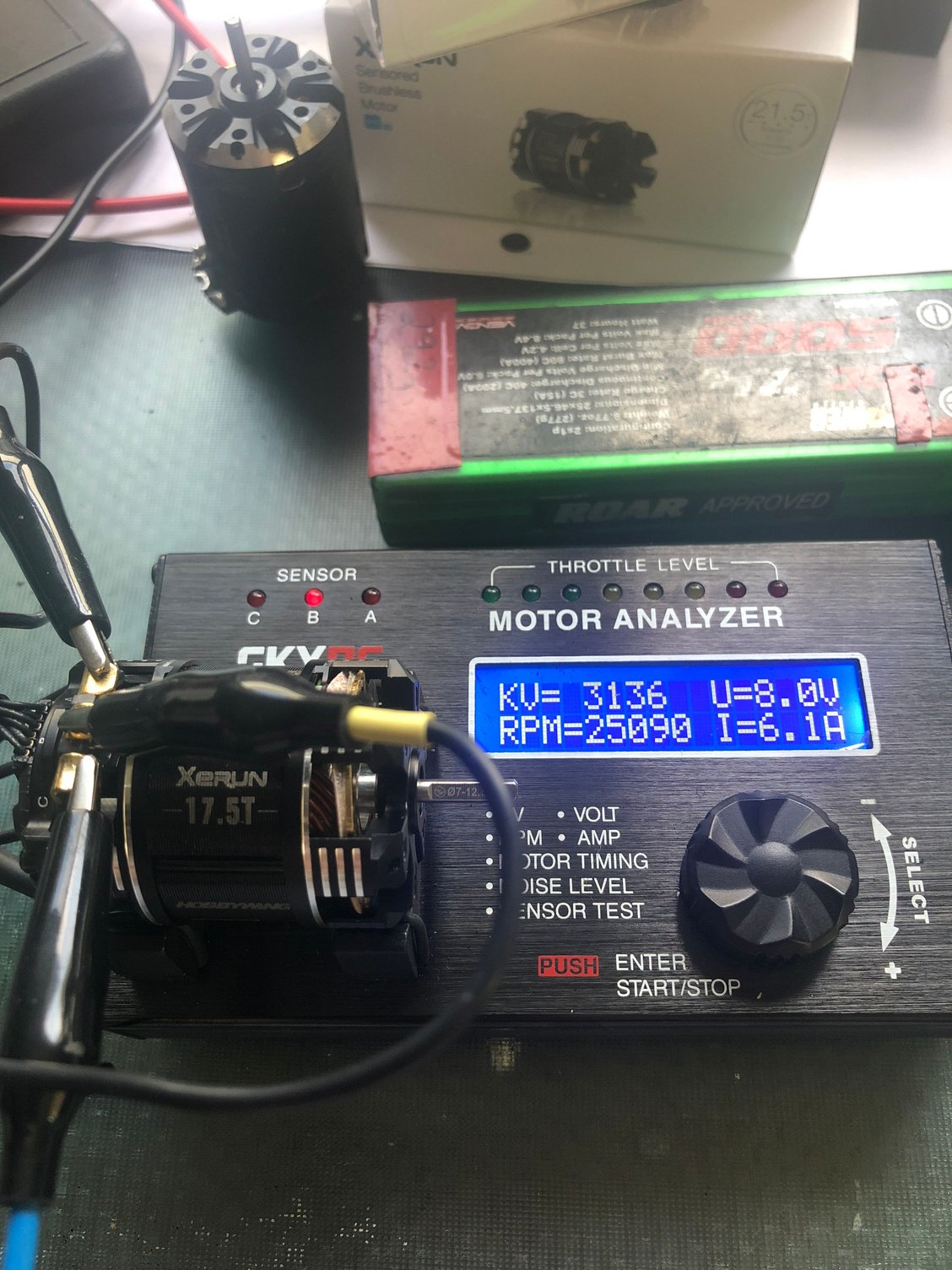

New G3 out of the box

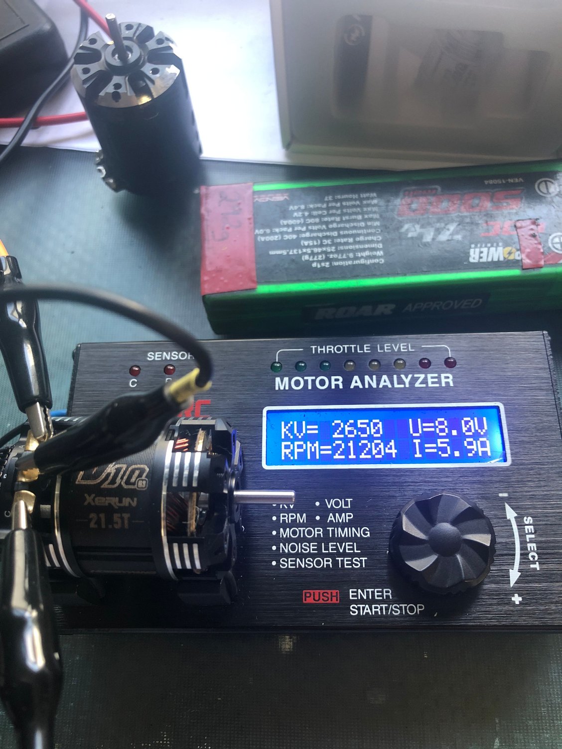

21.5 G3

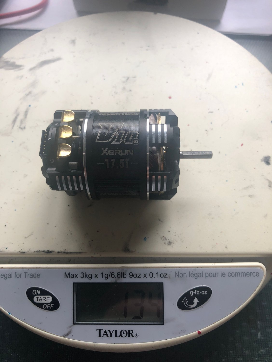

G2 173g
G3 134g

what were the number differences when you did the V10 at the same 6amp or vice versa with the G3?
Do you feel the 6amp setting is the more close to optimal where you will end up with the G3? Seems a lot of newer motors these days the optimal setting is less than the 6 amp thing so curious.

I am going to sit down and find the optimal timing for the G3. I think I am fairly close as it jumped to 7 amps with only a minor increase. I was around 52 degrees. The G2 at 5 amps was the optimal point. I also have another 17.5 G3 to test.
