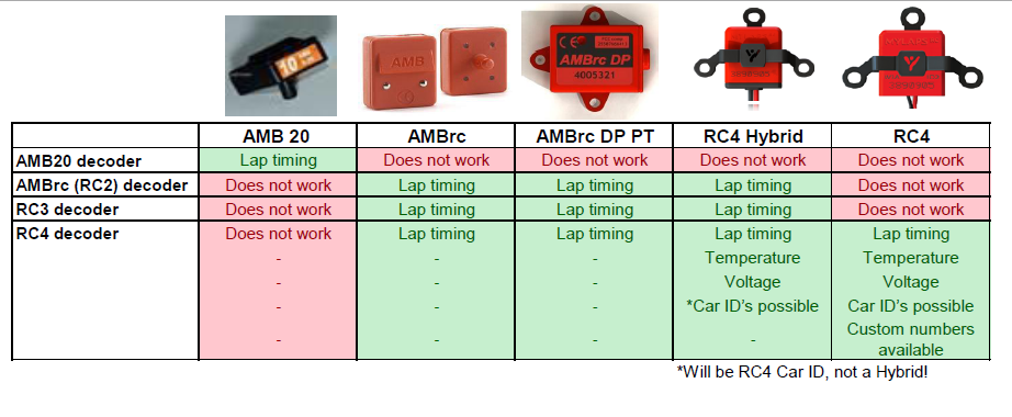

Are the brand new RC4 pro transponders backwards compatible with any other older equipment?

I've updated the table to explain the thread's title

Would you be able to add mrt pt to that table? Its been a table i shared. Many times as we jave clubs around us with different systems

I'm afraid MRT made at least two revisions of their transponders. The first version was blocked by RC4 decoders. They updated the design because of that, but again have been left out by firmware 4.5. So an earlier MRT might not work with a RC4. The newest MRT should have same compatibility as AmbRC (that is up to firmware 4.4). If somebody can confirm this I'll update the schema

yes, MRT released the (NS) "new series" version of the PTX-20-NS which supports up to AMB 4.4 they also have a newer design with a smaller footprint than the PTX-20-NS which provides the same support, the latest version is called the "mPTX"
