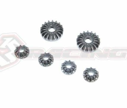

Are these worth it? Does anybody use them? I have a 3Racing S64 setup for VTA, 25.5 turn motor (HW G3R) 2s battery, 87/48 s/p FDR 3.44:1. Besides longevity and extra weight are these really needed or just hop-up bling and fluff?

For a 25.5 motor you're better off with the lightweight plastic gears. Metal gears are for when you're putting a lot of power through the drivetrain.

Many years ago when I used to race a TEKNO EB410 on turf with a 13.5 motor they had released lightweight plastic diff gears as a performance enhancement for stock racing to help reduce rotating mass... I couldn't tell any difference in performance, my lap times were the same and the gears stripped within 3 race days I went back to the stock steel gears... so in your case I would not upgrade to steel unless you're stripping the plastic gears... for VTA you will more than likely do fine with the plastic gears.

But Bill, off-road is a totally different story, since every landing after every jump sends a jolt through the whole transmission. There I also only use steel bevel gears and steel pinions. In On-Road however, especially stock classes, any decent quality plastic should work fine within the diff (as do my alu pinions, may even try a composite one some day)

DirkW, agreed, though if for some strange reason he starts stripping plastic gears due to some sort of phenomenal grip scenario, then the steel gear option would be worth considering, though I bet the plastic gears will do perfectly fine for VTA speeds.

Sure, if it should really happen that the plastic gears go down, one might consider a steel replacement, but I doubt that will happen (although I don't have any first hand experience with 3racing plastics - but I've never had any trouble with the plastics in my Xrays).
