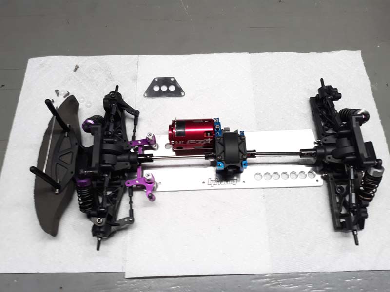

First thing to do was strip, clean and assemble the diffs. No idea on the best drag setup for an AWD car, so I took a stab at it. Front diff is locked with an Axial locker, rear is limited slip for now. Front has the HD gearset and the rear has an Axial HD underdrive set. I'm thinking a bit of front OD will help keep the car in a straight line. Hopefully. Found some universals too - bonus!
Drilled some holes in the nitro chassis and got the Associated trans mounted... it does have a center diff which sucks. I put the thickest oil in I have, but a locked setup would be nice. I think Associated makes a slipper set-up for this transmission, if so I'll be looking into it. Found some random dogbones in my stash, a full set of turnbuckles, and an aluminum steering set and it's coming together nicely!

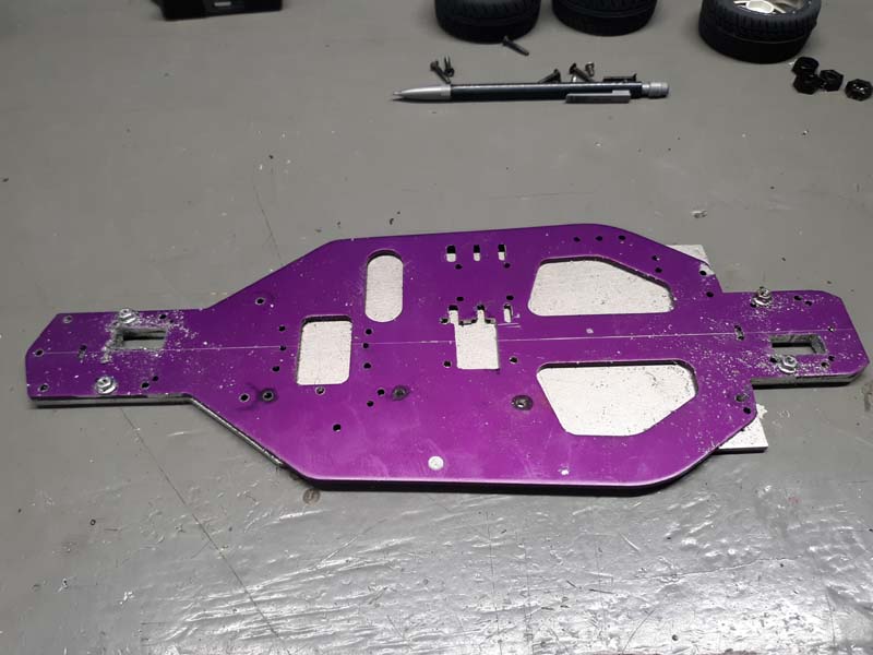

I knew the chassis was a bit tweaked, and I tried to bend it back straight and thought it was ok...while building it up, I noticed it rocked all over my workbench. I was tweaked diagonally too, not to mention swiss cheesed from all the extra holes. I like swiss cheese, but not on my cars. So I broke out some 3MM aluminum, clamped them together and started making a new chassis...
Couple of hours later, and I have this along with aluminum shavings in my hair.
Much better! Not only looks better, but straight as an arrow and much stronger. It's a bit on the heavy side, I may shave it down here and there where I can. Designed it so I can flip the trans so the motor can sit front or rear., and nice and narrow since it's going 30 feet in a straight line and anything hanging off won't matter so much. Going to start with the motor up front for now...Hoping for a 50/50 balance front to rear.

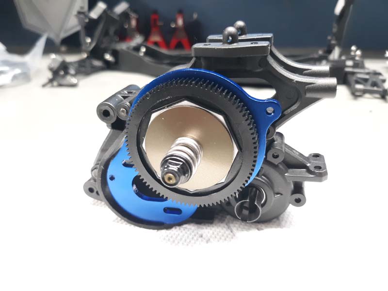

The rear of the chassis was a mother as well. The lower trans mount is a separate piece and was slightly wider than the chassis...So I had to spread the rear of the chassis a bit to get the trans mount seated... and that chassis is stiff as heck! Then I got to the top mount, and that was slightly narrower! I had to break out the plumbing pliers to squeeze the back of the chassis to get it to drop on. Actually worked up a sweat.... does that count as my daily excercise? (I counted it anyway)
Trans went together beautifully... Gears are slightly crunchy in one spot, I'm sure they'll wear in after a few runs.

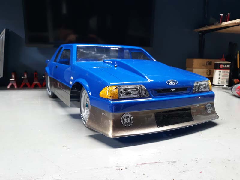

In the meantime, I painted up a body for a friend of mine, and dropped it on the DR10 just to see how it looks. I love it! Might be one of these in my future. Really digging the No Prep scene - cool bodies are everywhere and big fat rear tires never get old.

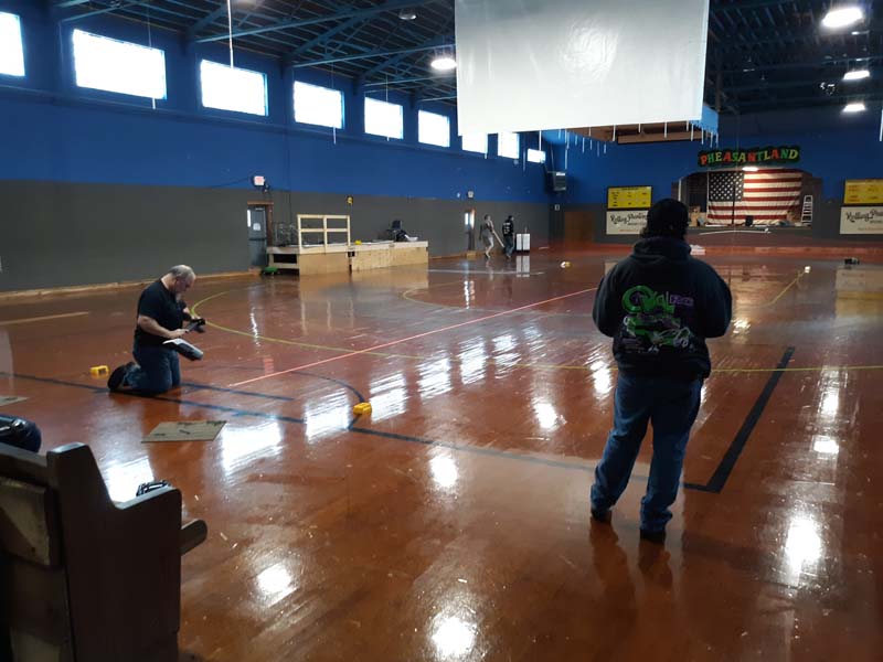

Anyway, off to the track. I didn't get any pics per se, so here's a gratuitous shot of my pit area.
Turns out going fast and staying in a 12' wide lane is a lot harder than it looks.

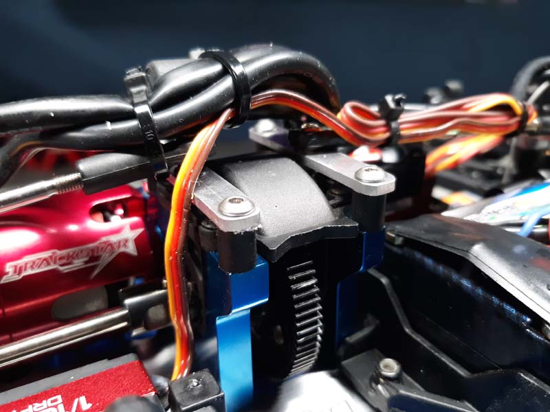

Swapped in a sensored system so there's no more off the line cog...I moved all the electronics along the centerline. Not sure why I didn't do this in the first place, seems like a no brainer.

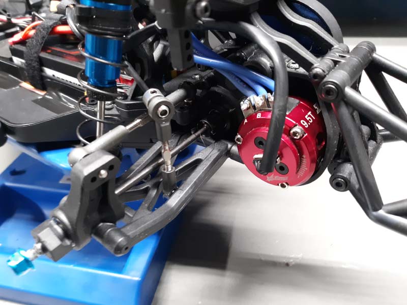

Now running a 9.5 motor (4200kv)... some of the guys are running 4.5ish motors, but with the surface we are running on, it's really hard to put down the power. Will see how this does before considering anything stronger.
Noticed the front was a bit sloppy towards the last few runs.. the front C-hubs had developed a ton of play. I'm sure it had nothing to do with ramping off the end timing setup and barrel rolling a few times. Weird. In any case, nothing some shimming won't take care of.
Experimenting a bit here... some guys run spacers to keep the front shocks from compressing too far. I tried pen springs on the shock shafts. So far, it seems to be working well - still prevents the front from compressing all the way, but has a nice soft feel when the front wheels load back up.
