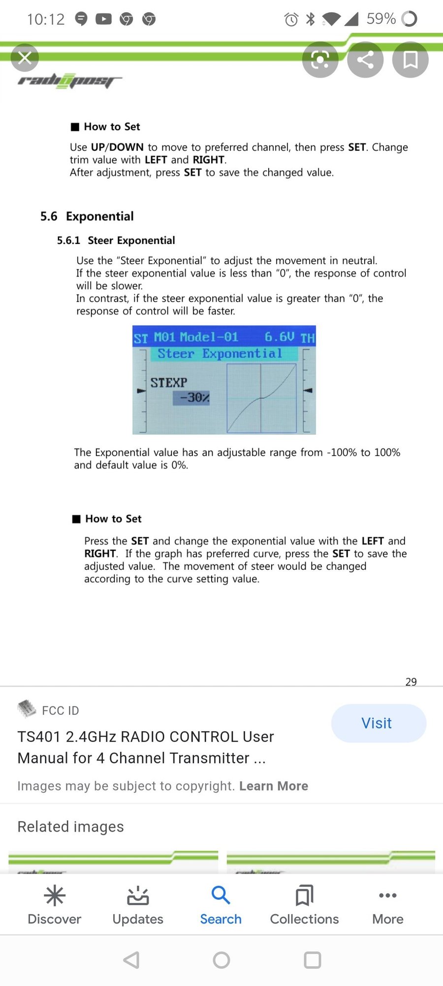

I don't think messing with expo is good thing to teach a new driver. The steering is no longer linear and it does weird things when you are trying to do mid corner corrections. I would say the best is to mess with dual rates. Run as little steering as you and still be able to rotate the tightest corner on the track. When you dial down the dual rate, by default, it will make your steering less sensitive by having your movement of the wheel translate to less movement on the car, but it will actually be linear. As you get faster and more consistent and want to push the car harder, then you can put the steering back in and it will react faster and it will actually need more steering angle as you are cornering with more speed. Also get the fastest servo that you can and make sure you radio has low latency. That affect how connected you are with the car. If the servo is slow as dirt, then all the corrections will be a step or two too slow and you will always be chasing the car, same with a very slow laggy transmitter.

I see you have very little on the expo and what it does...it only has limits in the 1st turn of wheel not throughout entire steering range.

Expo is a curve, it is not linear. The curve is flatter in the initial movement and then it ramps up exponentially like a wall hence the name. The greater the expo, the more exaggerated it gets. So if you really dull out the initial throw, right after it will almost go full travel. Messing with dual rate actually affects the steering in linear rate at the expense of maximum steering travel.
Edit: no i didn't need to look this up. Read my original post. But look at what I am saying in graph form. Most high-end radios even graph it out for you

Expo (or curve) should not be as dramatic as you describe. A lot of people use it in small amounts, around +/-10 is reasonable.
I use it mostly on throttle, adding near neutral for stock, and softening it for mod.
If you don't believe me, watch this video from Michael Orlowski. I don't remember where it is in the video, but he discusses Expo.

Maybe I am speaking anecdotally from personal experience. I used to use steering expo as well but I just couldn't drive consistently and it was hard for me to do mid corner corrections. The local racer told me just turn it off learn to drive at linear and if the car is too reactive you dial back the dual rate where the car can still do all the hair pins and then slowly dial your steering back up as you get more faster. That seemed to do the trick for me for the mini z, usgt and stock 2wd buggy for both Astro turf and carpet.

ive used expo for steering for 25+ years only thing it did was correct my slight shake in my rt hand.. set it at -12 work thru turns and no straight difference going into a turn...

+1 for negitive expo depending on setup, sometime you need that first 1-2* to avoid a crash and the 4-5* puts you into the turn marshal. Trying to clean it up. with that said depending on the car ill go as high as -35, and id rather do this then readjust the toe, to gett eh same... similer effect. it also quick to change back if i found i don't need it that day or went to far.
