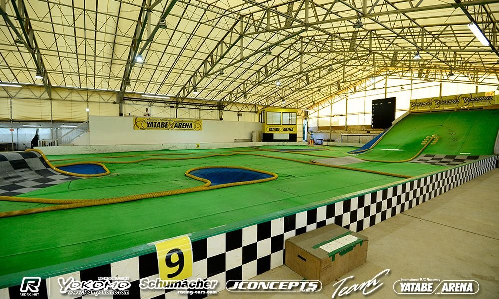

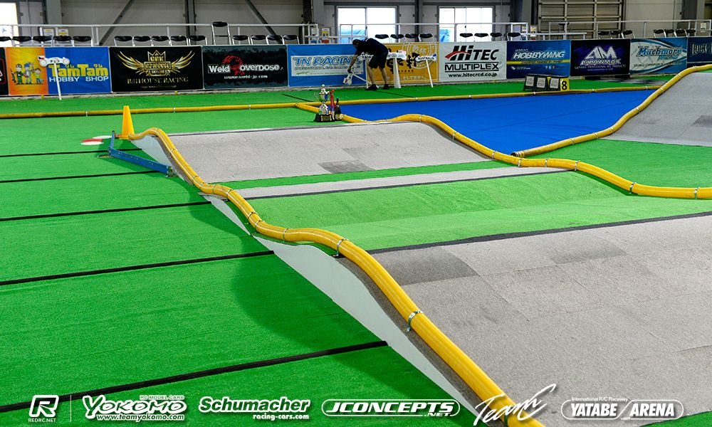

I recommend a clean astroturf track. Unique, fun, extremely low tire wear, and it's clean. Track needs to be at least 100x60. 150x100 would be good. 200x150 would be excellent.

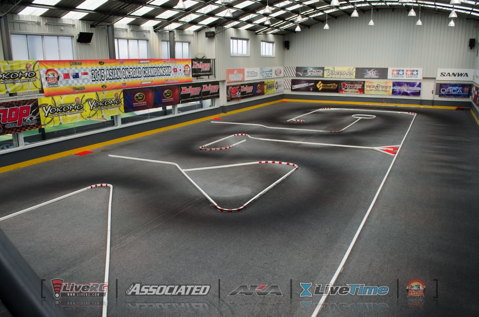

Indoor carpet on road tracks can be much smaller. 90x60 maybe. If you're tight on space go carpet onroad only. Save the dirt for outdoors.
Drivers stand should be as tall as possible. Floor 7' below the ceiling. All the way up. Nose bleeds. 99% of Ohio racers have never seen a real drivers stand. Don't puss out on the drivers stand.

If you're doing carpet on road only indoors, 36" of pit space is plenty. 48" is luxury. The 5' you mentioned.........is just excessive.
Even Yatabe's driver stand sucks. You have all of that head room.....
