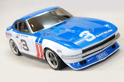

I think that Camaro has survived several generations of the HPI collage poster. I have been trying to get a spot on it for my Facebook award winning Mustang. Ive been bugging Andy H., Schwartz and Buckner but they make no promises.
I know this is not exactly VTA but I thought you guys would appreciate it. I found it on the abchobbyusa.com page.
