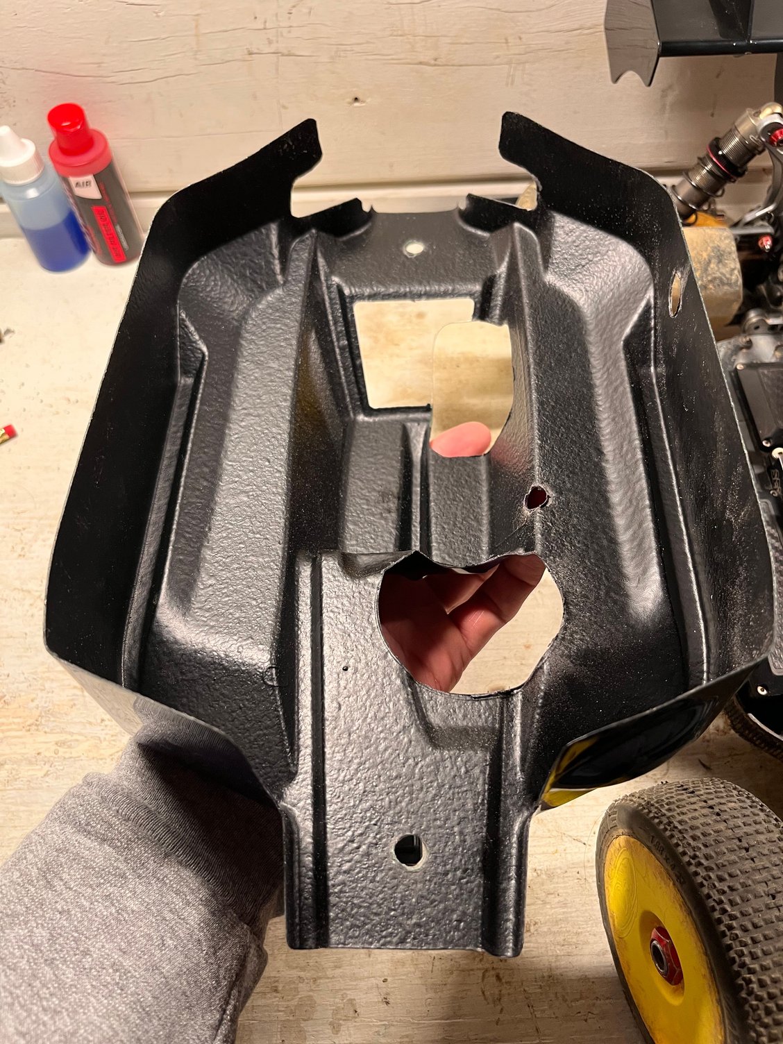

I’ve been using flex seal to protect the paint and add some durability to the body itself.
That stuff is THICK - Do you do anything in particular to minimize how much of a coat you put on the body?
TurnNBurn is offline
Old 12-22-2022, 08:12 AM
Join Date: May 2009
Posts: 375
I got the idea from a YouTube racer. It’s more for reinforcing the body, protecting the paint is a bonus. I do 2 thin coats, and I don’t worry about missing any spots on the first coat otherwise you’ll spray too much trying to fill in the areas it doesn’t fill in at first.
I had a body that had drywall tape reinforcement and it was cracking real bad. The flex seal saved it and I still use the body for practice.
plus it gives you the tinted window look 😂
