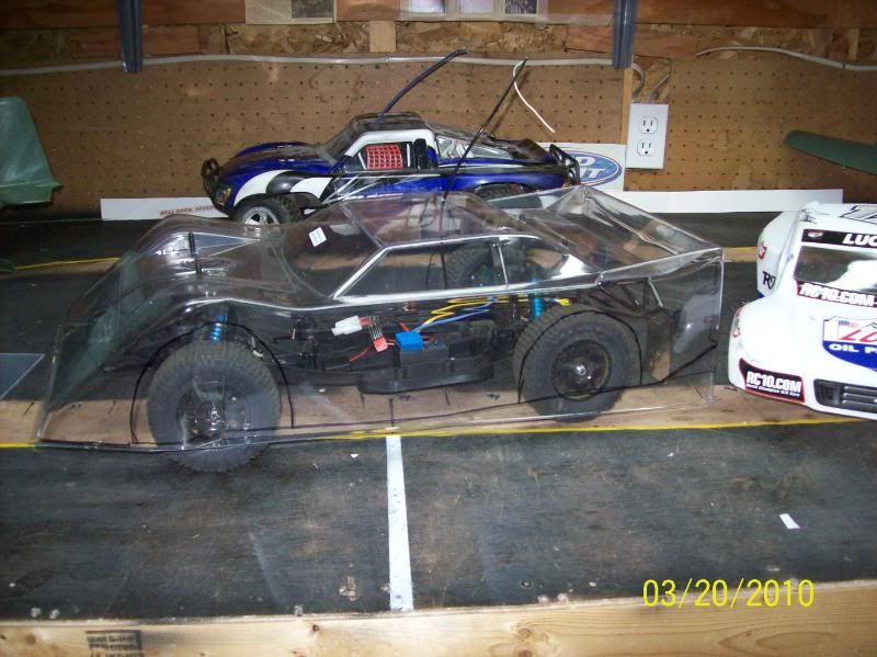

hey guys does anyone have a pic of a stock short course truck with a late model body on it?
would love to see what the look like before I go out and buy the body.

Here you go
[/IMG]
Slash 4x4
[IMG][/IMG]
Blitz
