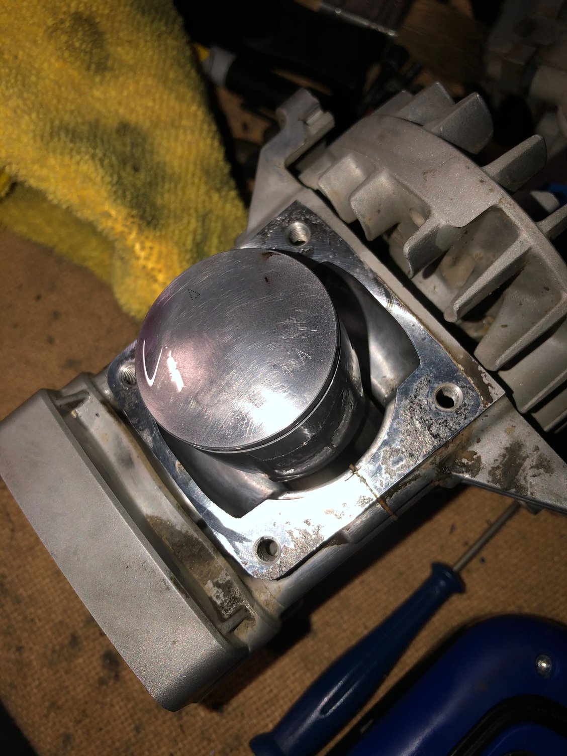

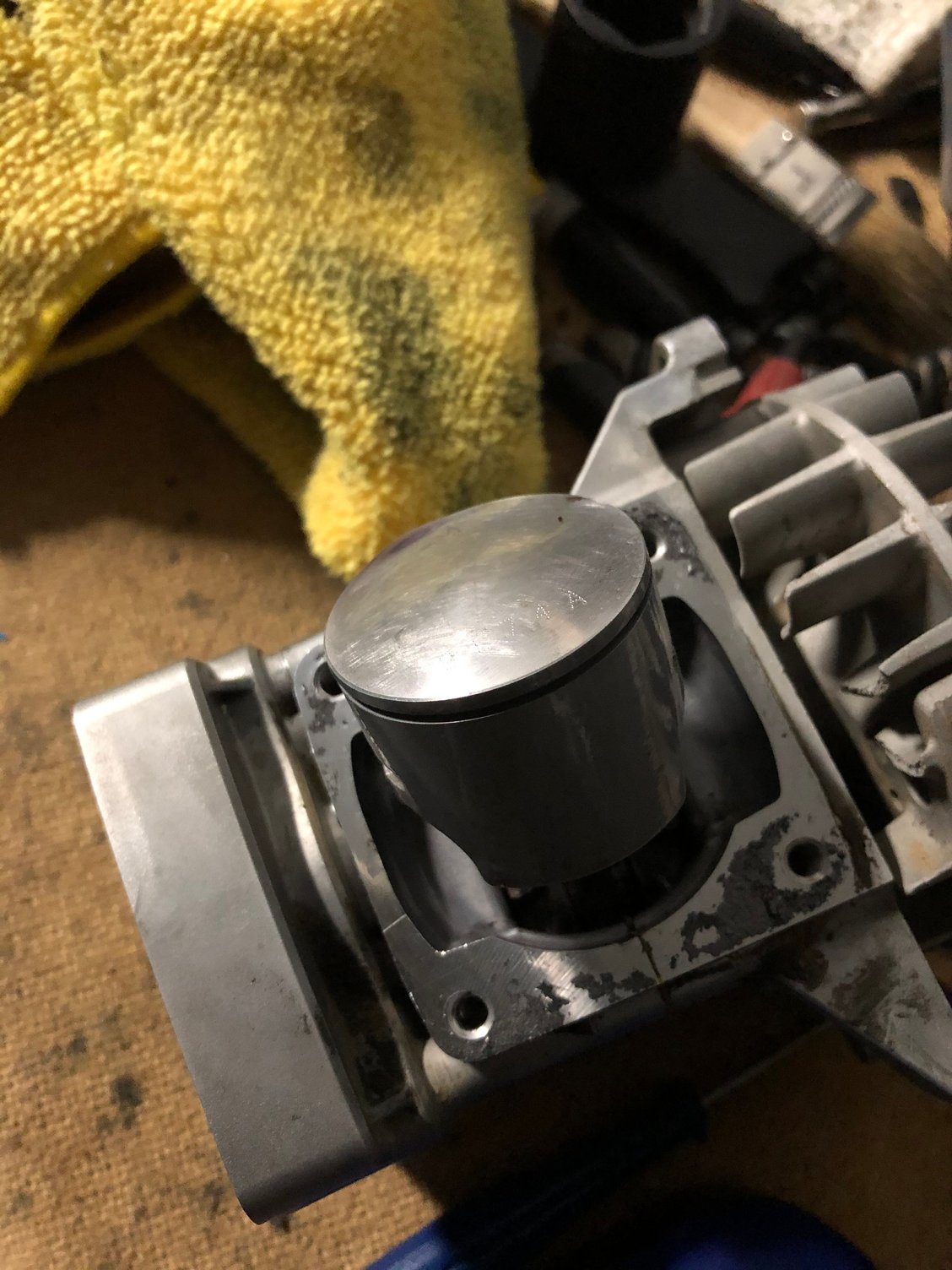

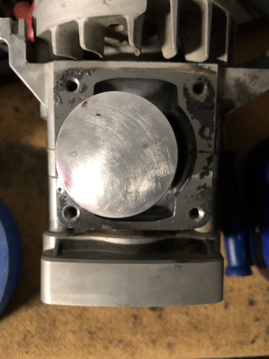

Need some help... so I opened my zenoah g320rc engine to put a new piston ring, and I decided to clean the carbon off my piston top, so I grabbed some 500 grit sandpaper, soaked it in some 2 stroke oil, put some oil on the top of the piston and decided to go at it, after that I noticed this...
I hope it’s alright.

Originally Posted by the rc guy View Post
the scoring you did when u use 500 grit is ok. Id be more concerned about the 2 carbon impurities in piston to...
would you think it’s ok to run? Or is it damaged really badly now?
so do you think this was via oil or your doing?. I think this was a manufacturing defect when aluminum was made... this looks fine id replace that piston but I don't run fossil fuel stuff only full sized things. seen spark plug damage look way worse ran for years after then seen les blow.you make call
no this was not the oils doing, I had lots of carbon on top of the piston, so I sanded the carbon off with 500 grit sand paper that had 2 stroke oil on it.
with that defect in cylinder head you'll always get carbon build up..
so would you say it’s okay to just run it?

100% This is nothing to worry about, like at all... Think about it for a sec, what could those minor sand marks do to mess up fuel/air flow. As long as there are no finger nail deep scratches in the cylinder wall or big chips taken from piston edges there is nothing to impede fuel/air movement or lower compression. Run it and enjoy the fact you just saved by extending the life of your motor.
In the future, a little brake cleaner and microfiber cloth should be able to remove any carbon build up.
