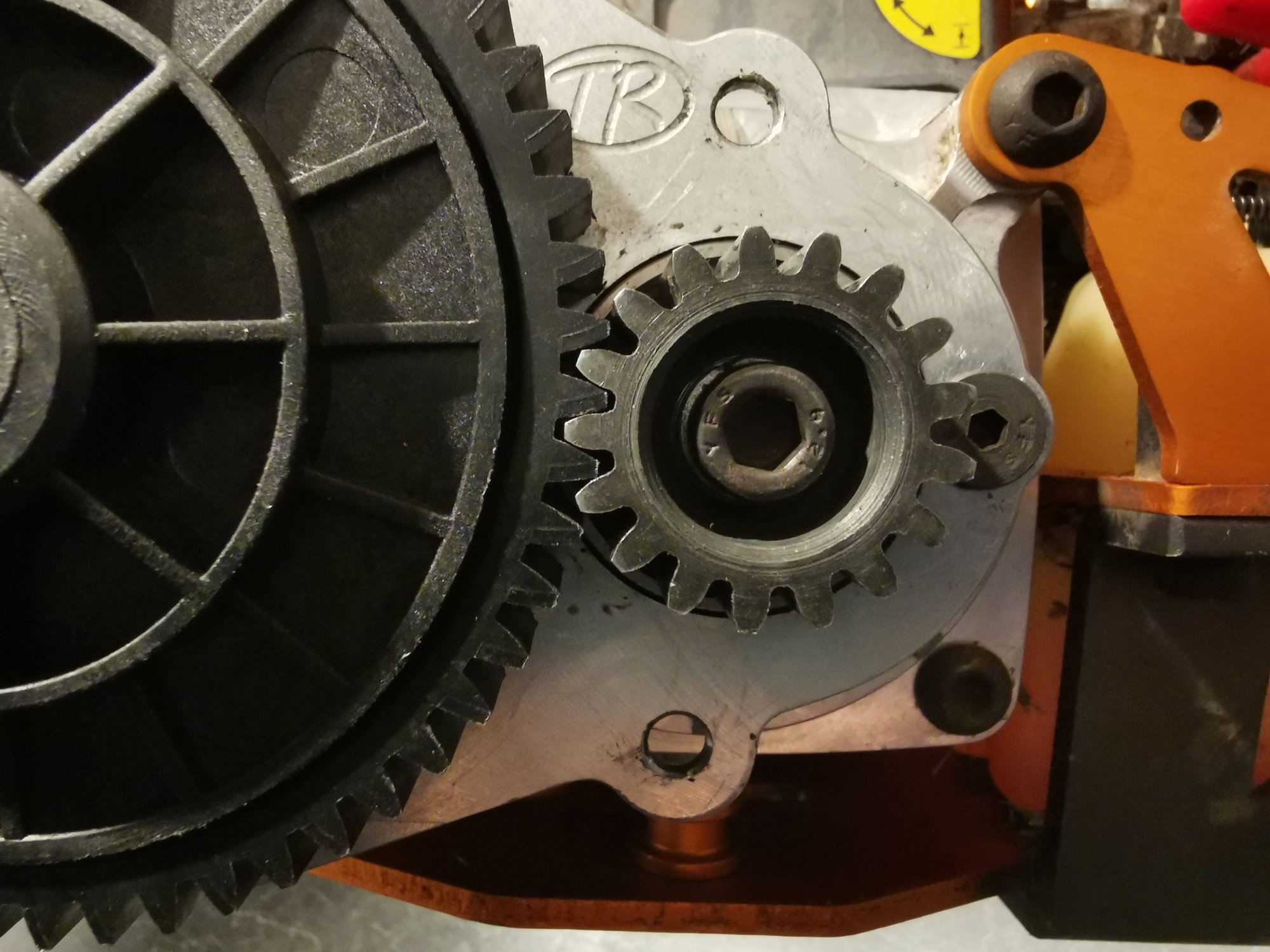

Next - the comedy clutch carrier and clutch bell. No matter which way you slice it, it just wasn't fit for purpose. The stock clutch bells simply weren't round so they quickly destroyed the plastic carrier by killing the bearings, spinning them in the housing, melting the plastic, then destroying the spur. £££$$$. This happened twice. HPI sent the replacement parts FOC, but it just wasn't feasible. So, enter: The Turtle Racing enclosed clutch system. Problem solved. 100% essential.
The TR enclosed clutch. 11 years on. Nuff said.

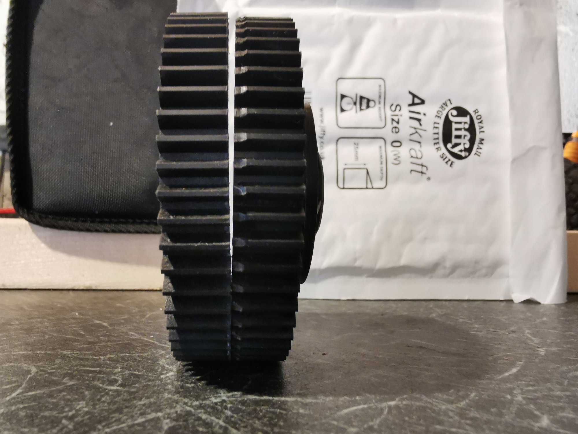

The Trouble With Plastic Spurs....
There's always debate about them and whether or not to go with steel. In fairness, this is the first plastic spur I've stripped since running the TR enclosed clutch. Sure, I've changed them out if they've worn or snapped a tooth - but none have stripped out before, not like this.
Turns out the bushings had totally crumbled inside the spur holder, so not really a typical spur failure. I've never seen these bushings perish like this, but they're really old!
So, new spur - easy fix, right? Erm, well you'd have thought. However, have a quick look at this:
The new spur is on the left. It has all of it's teeth and is fairly round. Sadly, that's where the good news ends, because as you can see, it's quite conical.
For a 'straight cut' gear, it's conical, with a difference in diameter of 0.5mm - which in gear terms may as well be half a yard. This 57t gear simply couldn't mesh and was ridiculously tight with the TR 17t pinion. The only reason I didn't send it back to RCModelz was because I used the holder and bushes it was supplied with on a different HPI spur I had sitting in a spares box.

Other fettling included needle filing the interface between the TR clutch and Pinion. Despite being made of steel and being held in by an enormous bolt, it had started to develop a burr. This prevented smooth removal of the pinion, so it was well worth the effort while it was apart.
Perfect mesh. Shouldn't be a mission to achieve considering pinion and spurs come in combos, but clearly the market is flooded with shoddily moulded spurs.
