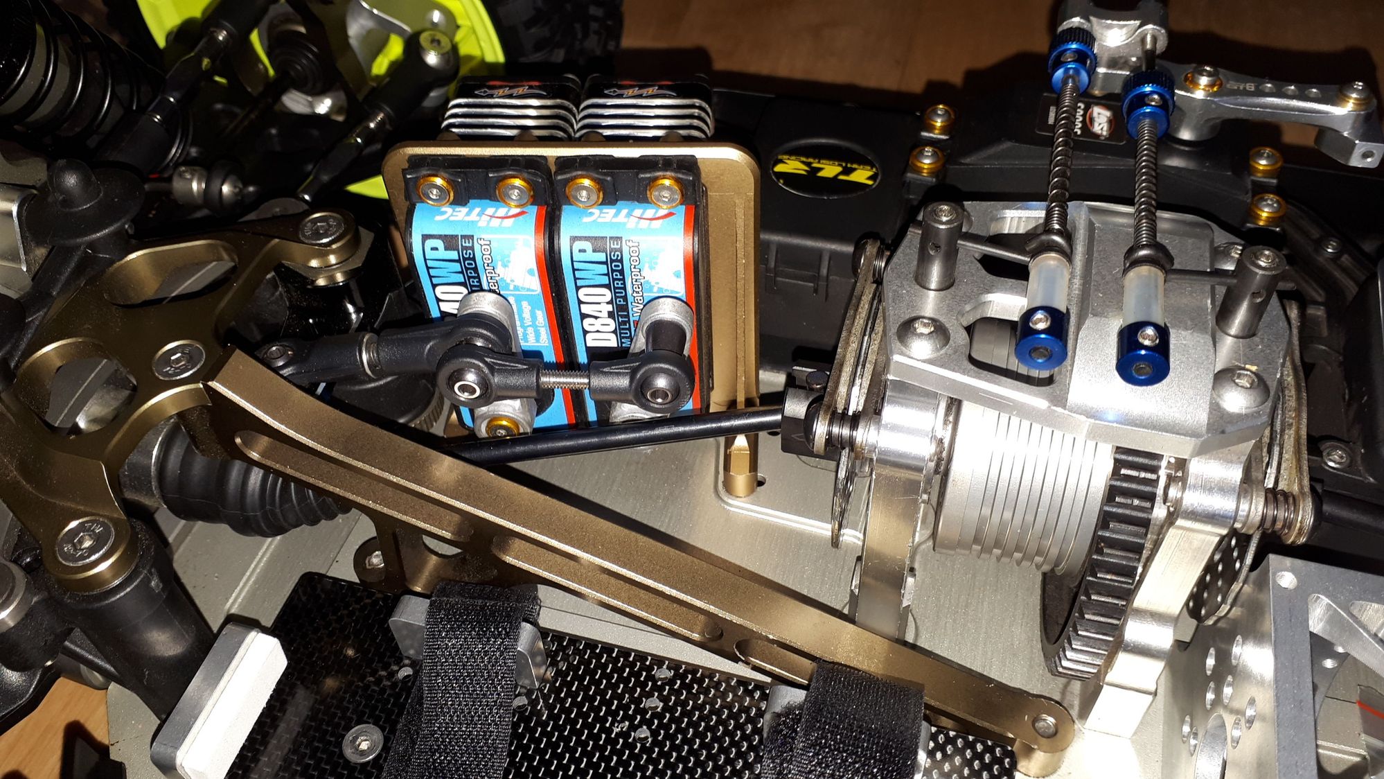

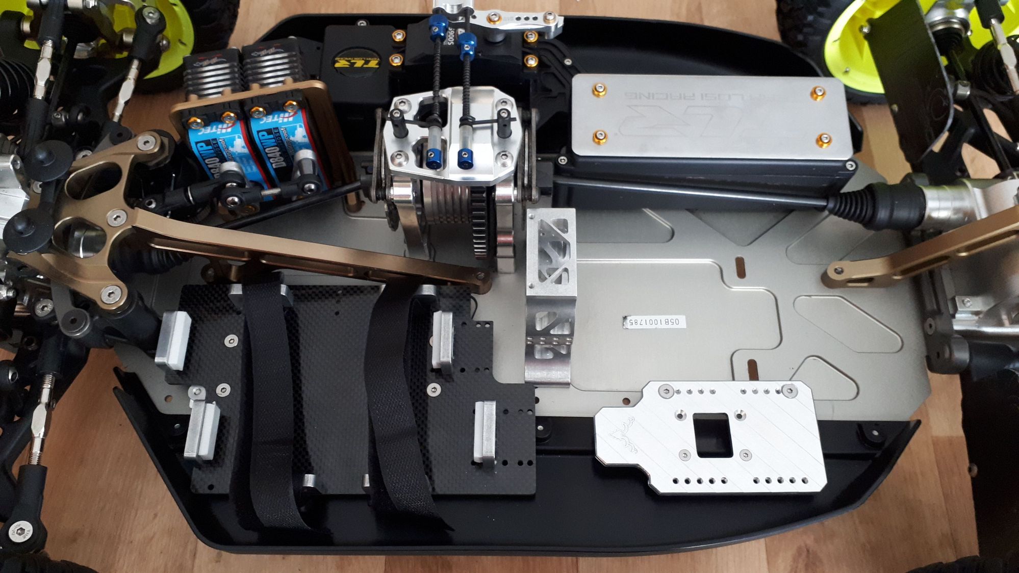

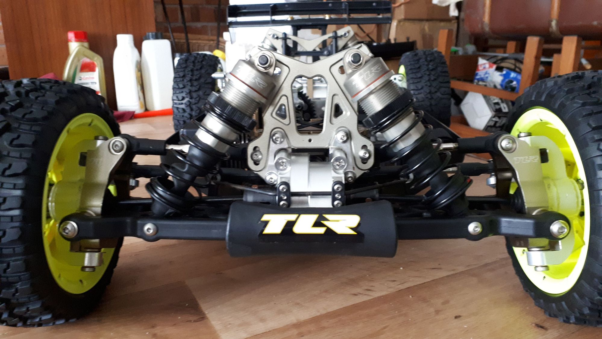

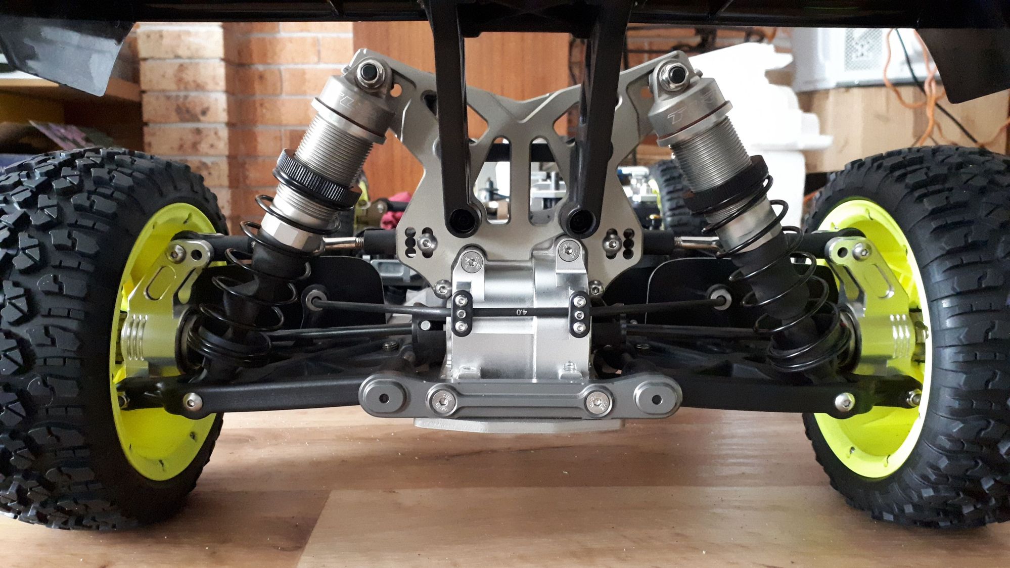

Hi guys, thought I would show off my 5iveB purpose built electric build, not a conversion as such if you know what I mean
Castle XLX 800kv combo with custom XLX alloy mount
2x Hitec D840 steering servos, Losi S900S brake seervo
Spektrum DX5R tx and 6000T rx
RC Madness BL5 V2 brushless conversion
Ice Racing front and rear diff housings
Rovan alloy diff cases
FLM "forever" diff cups all round
GTB front spindles and rear hubs
Losi front C-hubs, chassis braces, top plate and servo mount
Rovan centre diff mount
Losi 5iveT Flo rims with Nomad tyres
MCD RR5 bodyshell
All the aluminium upgrades only add a total of 551 grams to the weight of the base stock kit, plus an extra 61 grams for the XLX mount.
Total weight is just over 14kgs with 2x 4S lipos (31lbs)

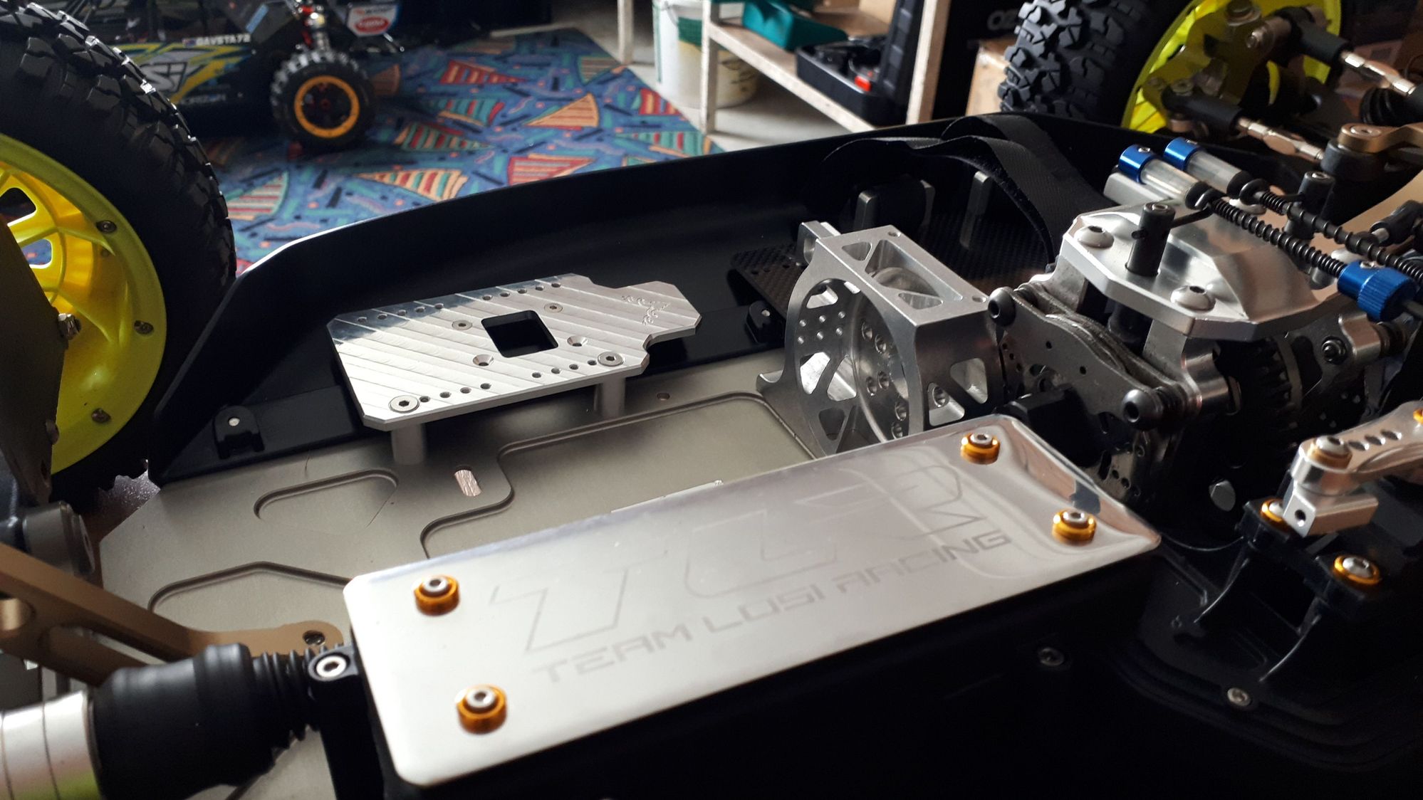

Those pictures were taken while I left the loctite on the motor to cure overnight, and unfortunately when I went to take it for it's maiden run it didn't go, the motor just badly cogged and didn't even turn
Anyway I sent the ESC and motor back, turns out the motor was faulty and Castle is sending a new one. It should be here early next week
I've also trimmed 10mm off the rear body mounts to lower the body further, it was only just above the side guards at the rear.

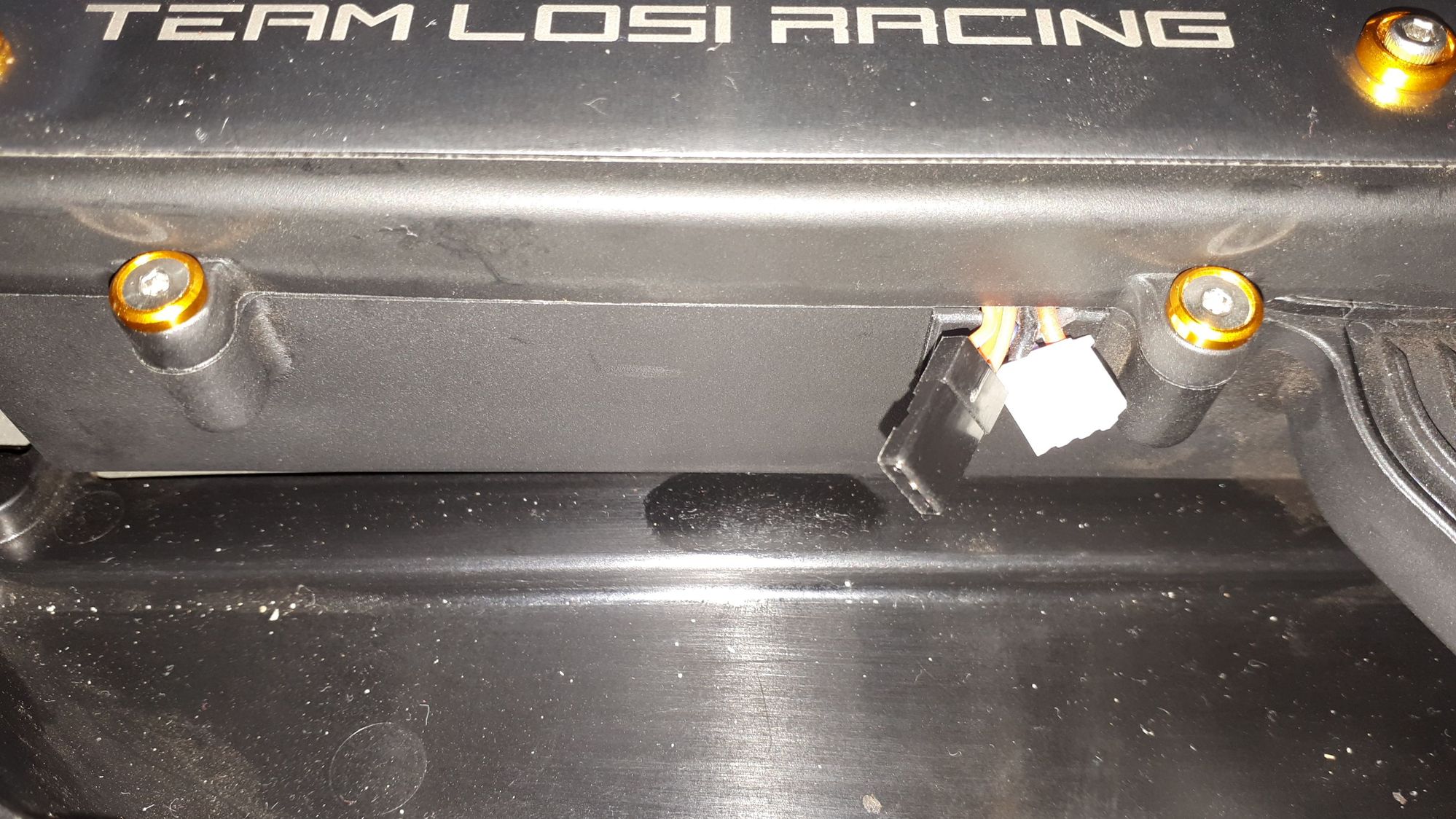

I'm also running all the electrics off a Turnigy NanoTech 2S 3000mah lipo, giving me 60amp BEC. The XLX only has 20amp BEC, the 2 steering servos alone have a stall current of 20amp, so it was a no brainer really. I ran the balance plug for charging, and the Castle Quick Connect out the side of the battery box

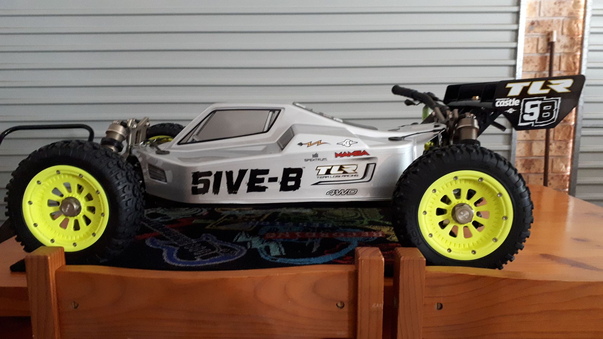

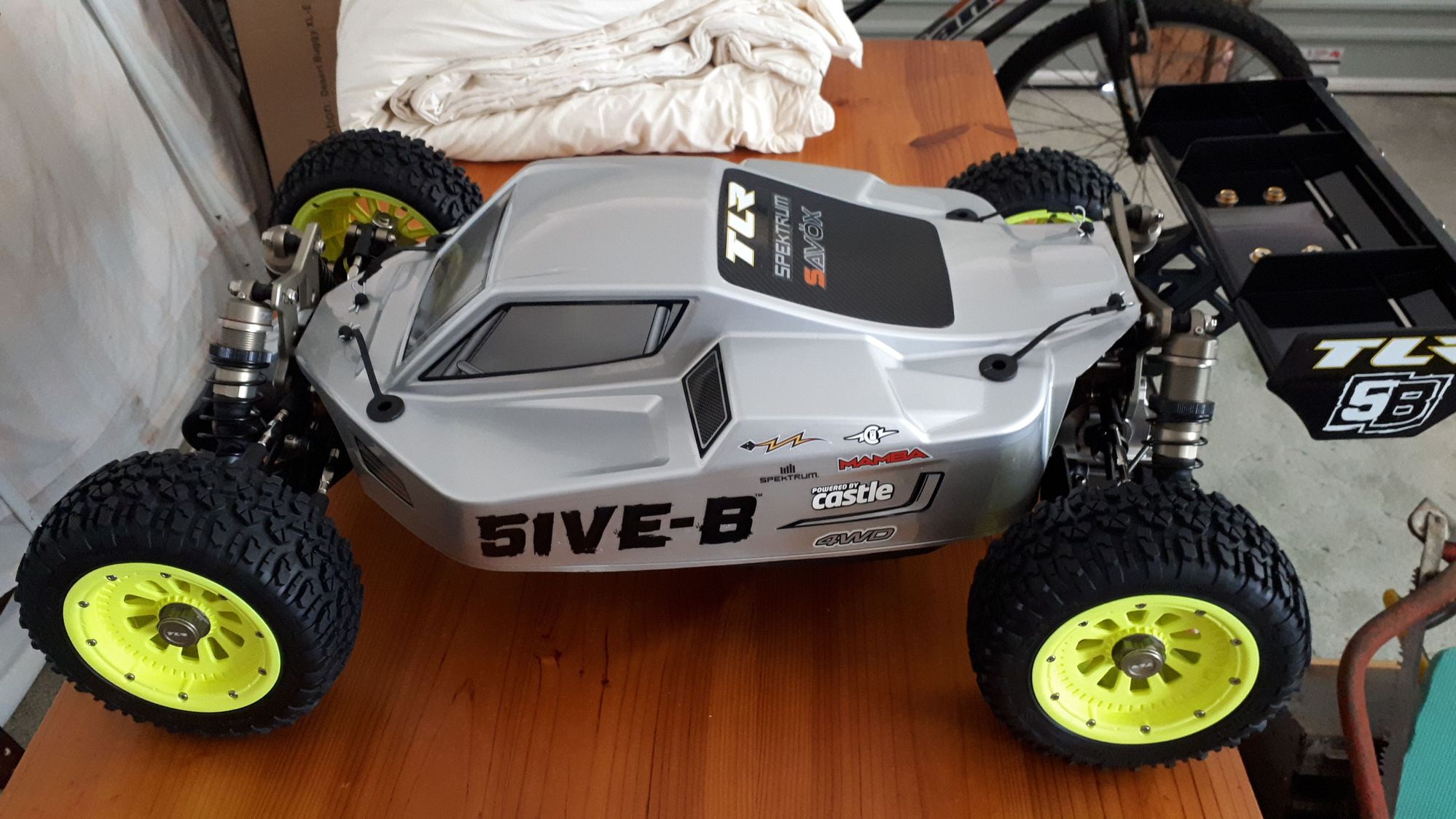

I agree the stock one is bulky, I was going to get the Grafil G-Forza, but it has the indent for the motor cut out. I just took a gamble after eyeing up dozens of pictures of the RR5 and thought "that'll fit" and it does perfectly....it's about 10mm wider where it meets the side guards.
It's thin polycarb though, but I've run duct tape all over the inside. Main thing is it has no holes cut-out. It also comes with stickers for the windows, body clips, and the body clip retainers - which are meant to go in the holes for the body posts, and the posts go through them - I worked that out after the fact
