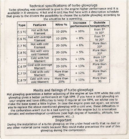

Simon M 06-12-2007 05:07 AM
1 Attachment(s)
hope this helps
Attachment 238951
