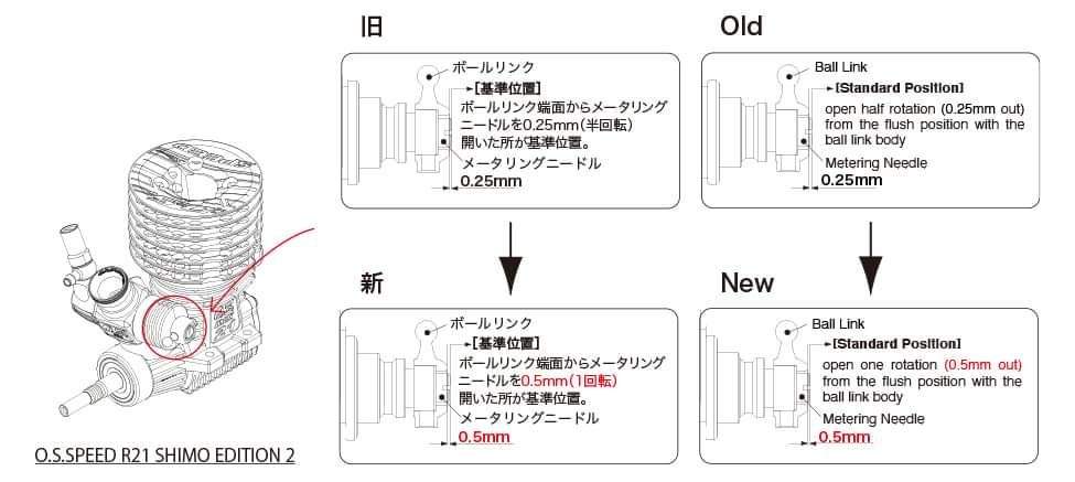

For those that haven't seen from OS,
metering needle too lean from factory see below

Hamish, did the engine come to life after? Or still a bit flat?
Hey mate, still havnt ran my own ones in yet.
Undecided if I will or not 😂
