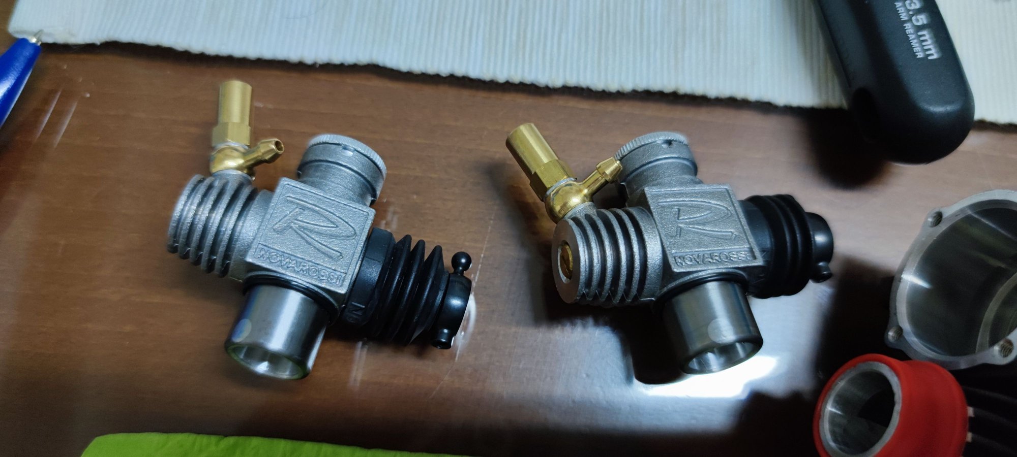

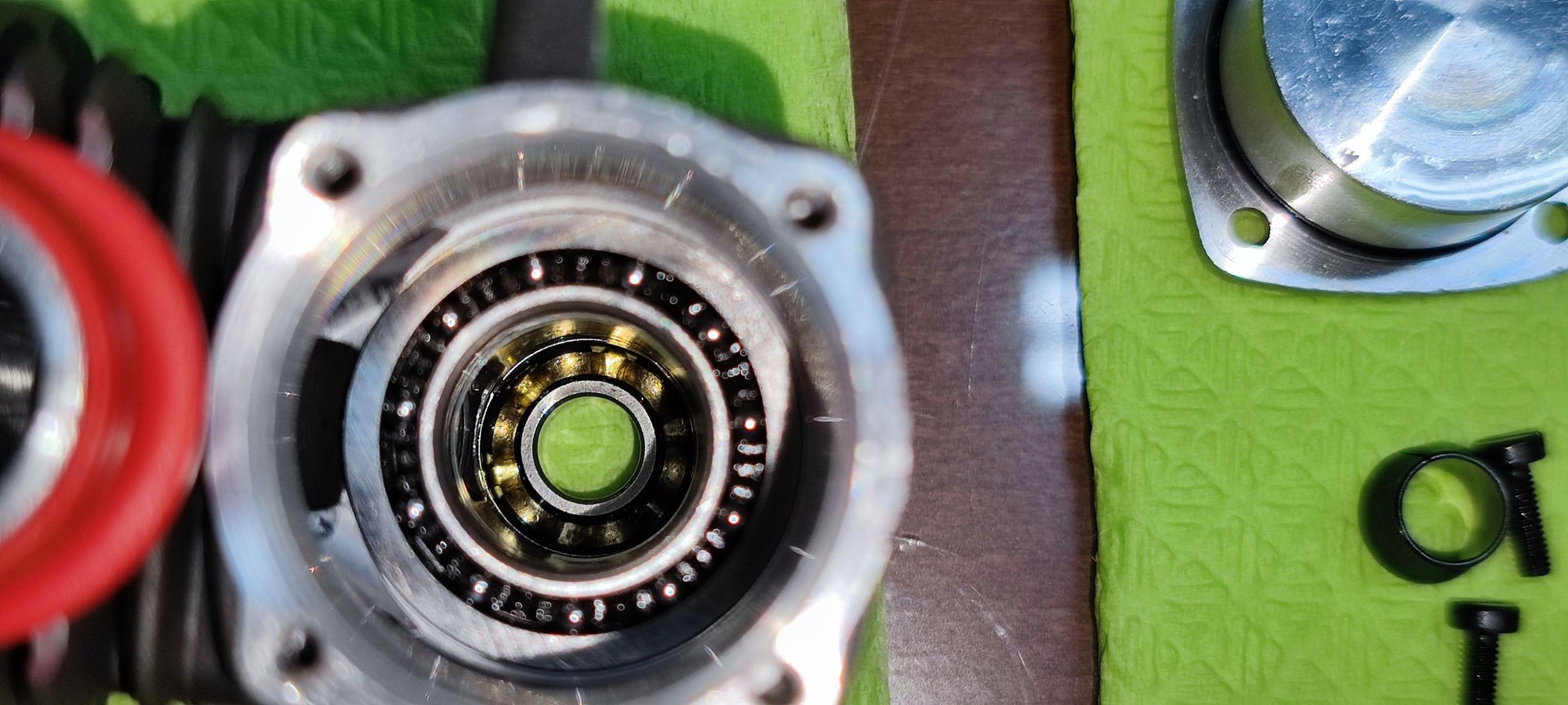

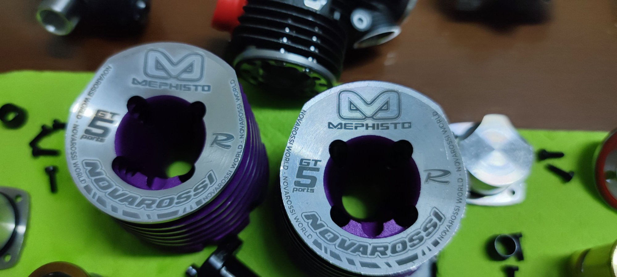

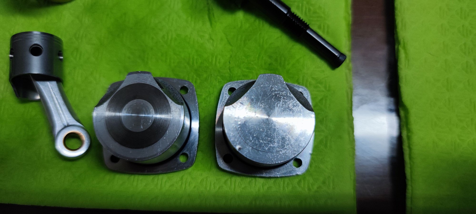

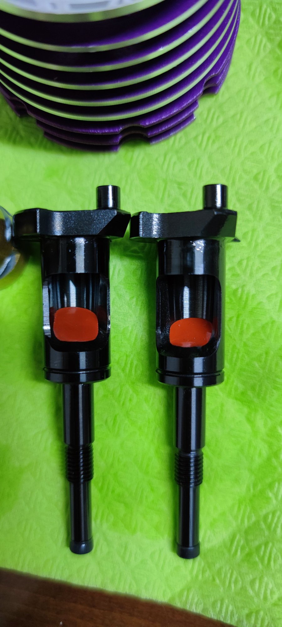

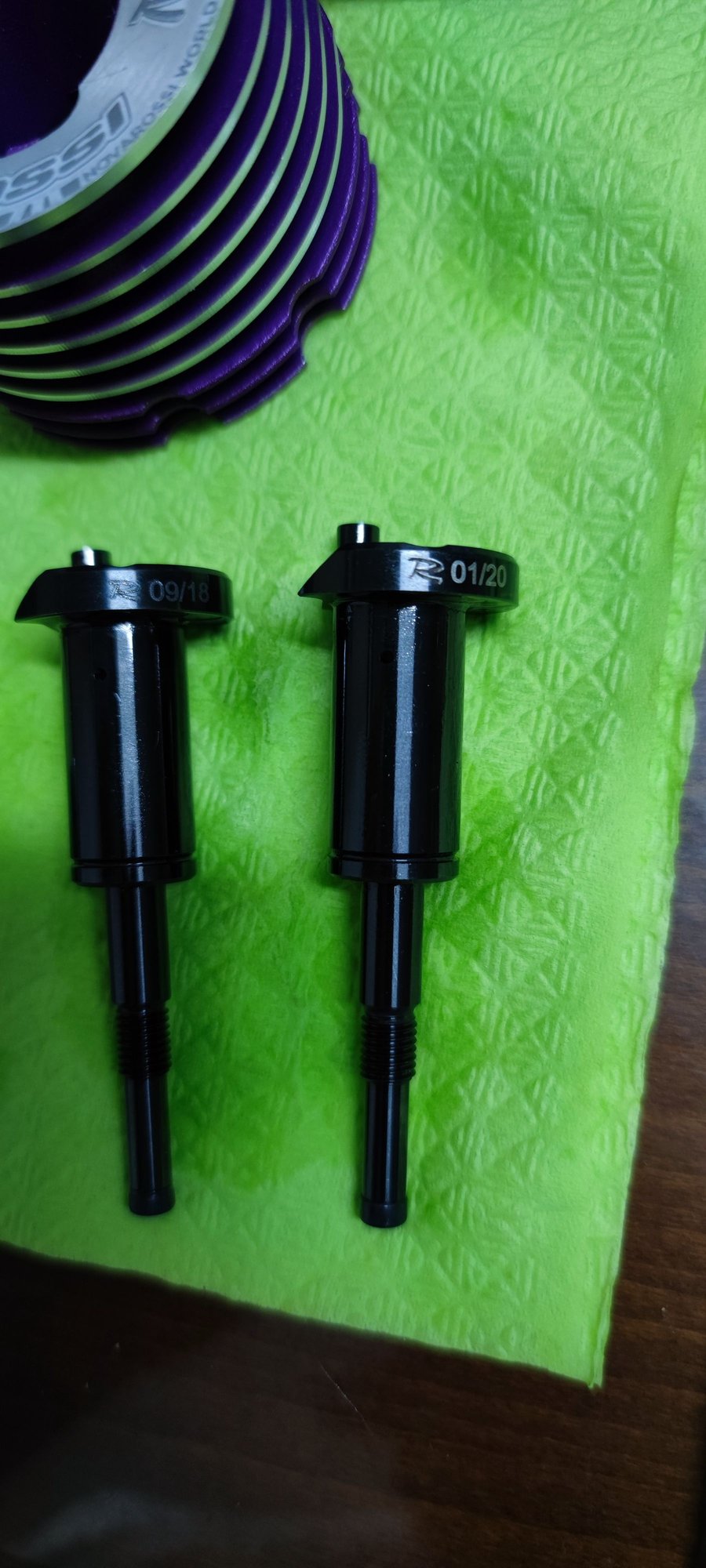

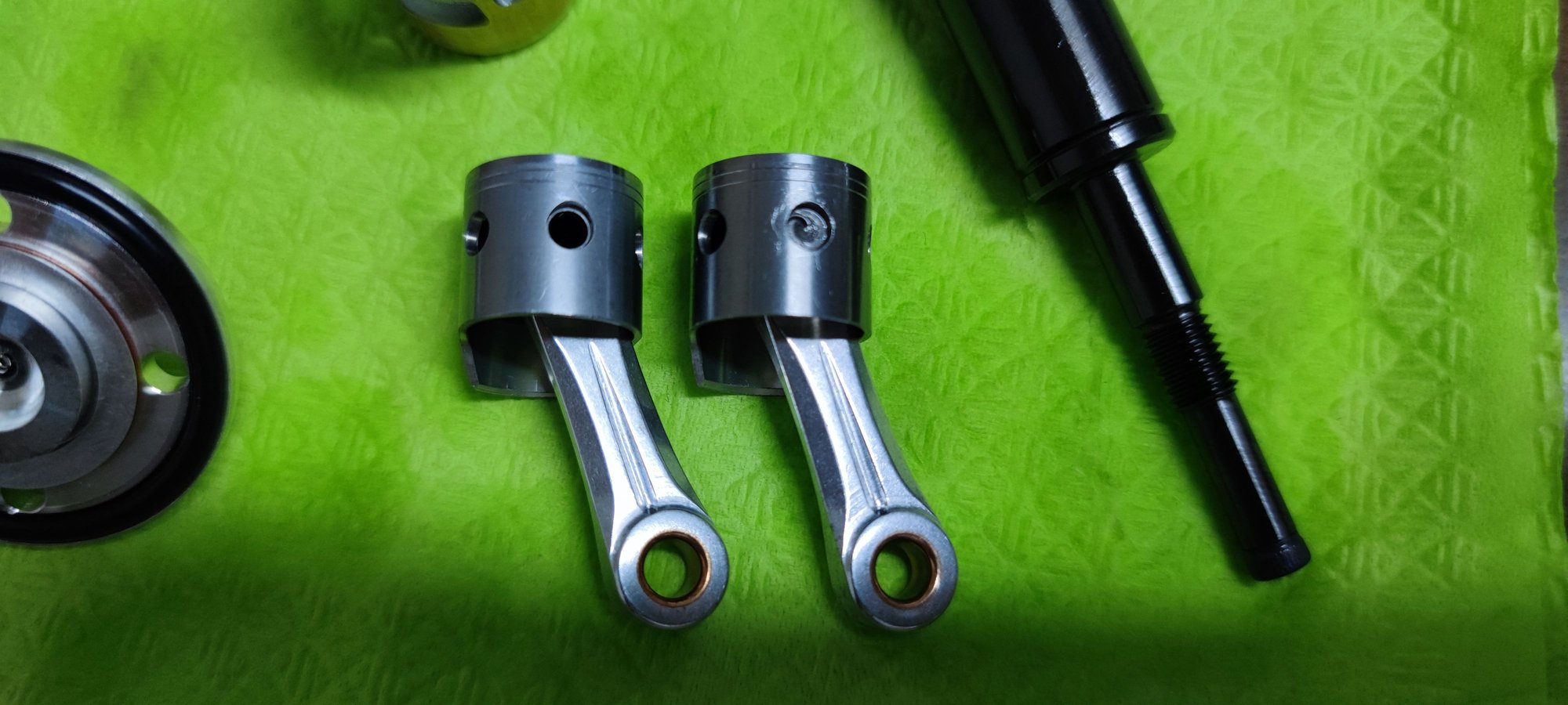

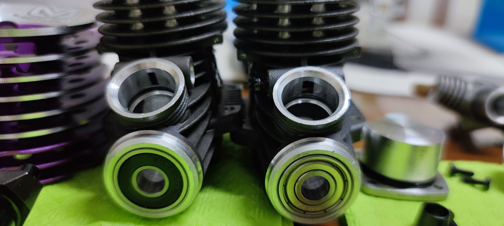

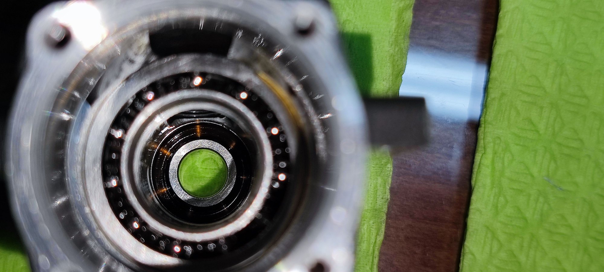

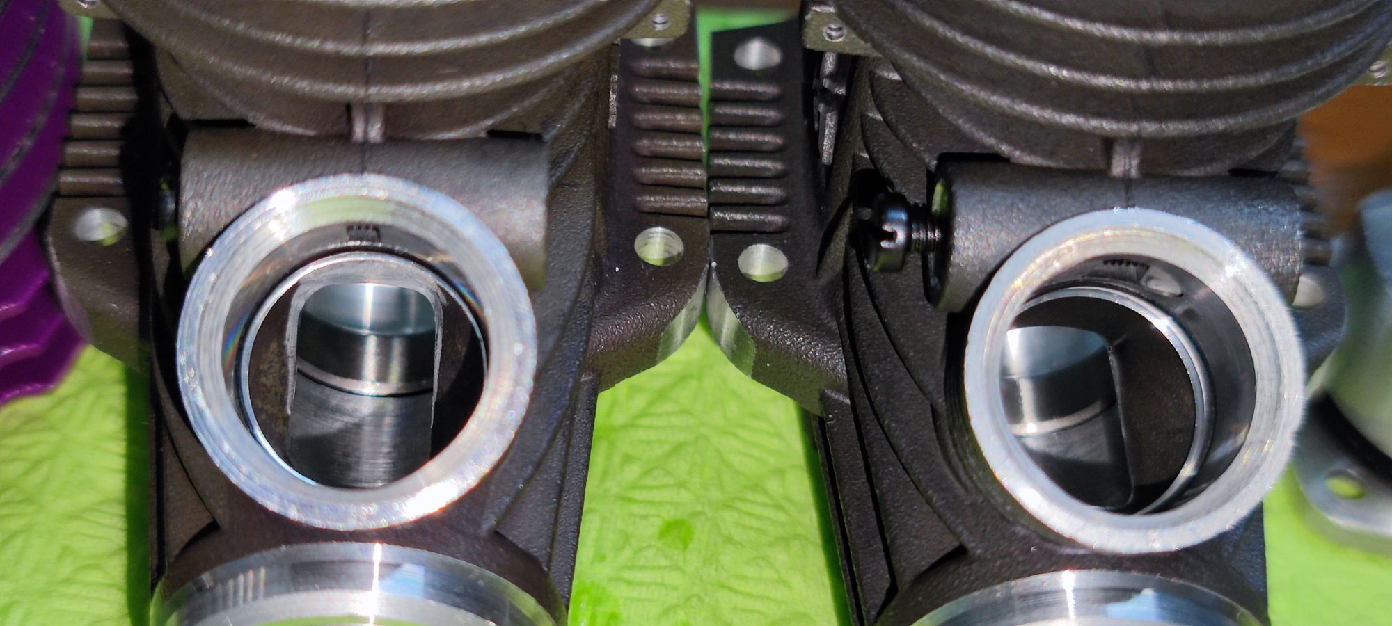

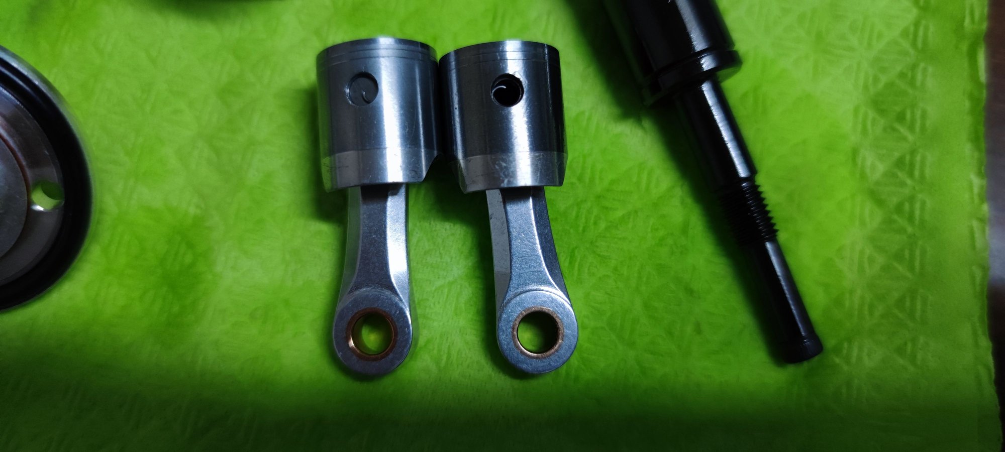

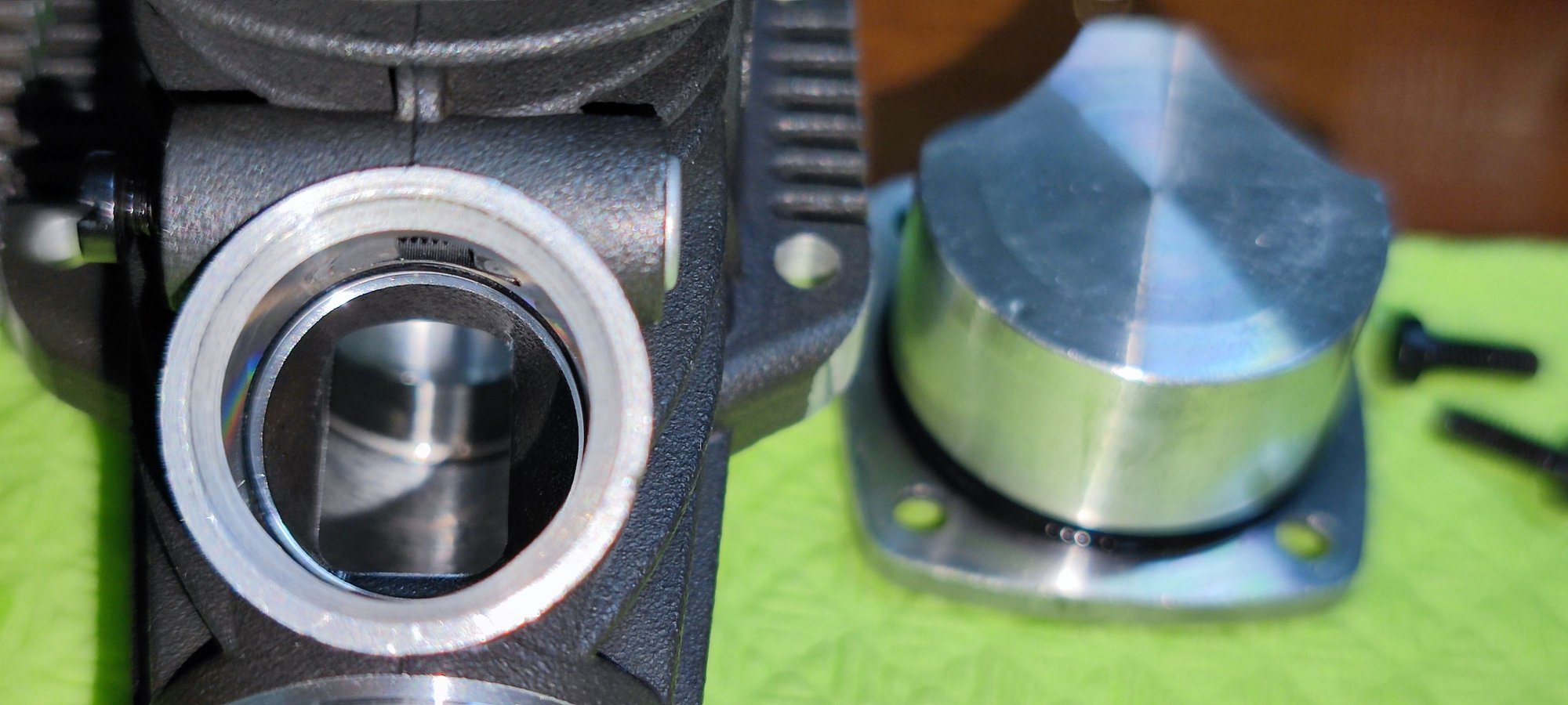

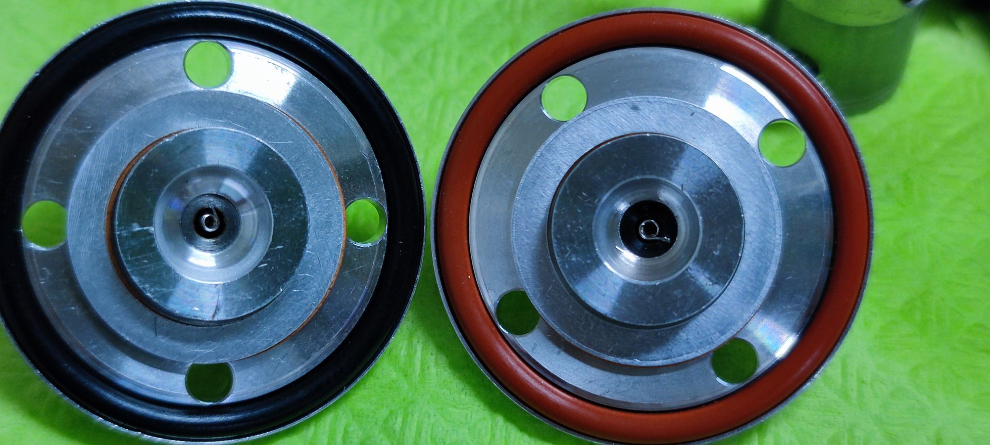

So, I received today 2x Novarossi Mephisto gt5 .21 engines and as always I open my new engines, dissemble them, clean them and prep them for hot oil bath break in..
But with those 2 something really odd is going on, its like they are 2 different engines.
On the one the headbutton has a bigger dome than the other and 0.8mm stack off shims, and the other has smaller dome and 0.95mm stack of shims, different crank opening and crank weights material and different front bearing, and backplate. On the one crank it says 09/18 and the other 01/20. The headbuttons, crankshafts and conrods don't have part numbers on them.
GeorgeCk is offline

Does any of you have a Novarossi Mephisto gt5 .21 to upload some pics to compare it with mine?

My experience is that between production series there can be differences. Also keep in mind that at the end several engines were just assembled with left over stock parts.

Yes I know but its like 2 different engines.

Visible They are different, performance wise they can be (almost) the same. The smaller burn room looks like a 16% model but then it is also shimmed higher to work with 25%

Thanks for the info!! I will change the 16% headbutton and shim it for 25% and run them to check if they are any different!!

My GT5 Mephisto had a DLC coated crank, the smaller bowl volume head for 16% and came with 1 alloy and 2 copper head shims. The head and rod were both laser etched with NR details. I cant post pics as my post count isn't high enough.
It would be wise to measure the squish clearance on both of those engines prior to running them, just for piece of mind more than anything. (in other words, not just counting shims and trusting it. Particularly with the one with a 16% bowl if you plan on running 25% in it.) 17 to 25 thou (0.45mm to 0.65mm) for the large volume bowl on 25%. I'm not a fan of shimming up for higher nitro personally but add 4 thou (0.10mm) to those numbers with the small bowl if that's the way you go. My preference is to go for the tighter values for squish clearance in GT's as the cars are heavy and the effective pipe length is longer, meaning less impact on peak rpm.

Thanks for the reply. I have the optional 28025 button head for 25% so I will change to those and shim the at 0.7 as their manual says for 25%.
When you are able to and if its easy to post some pics of the internals so that I can compare them I will really appreciate it!
