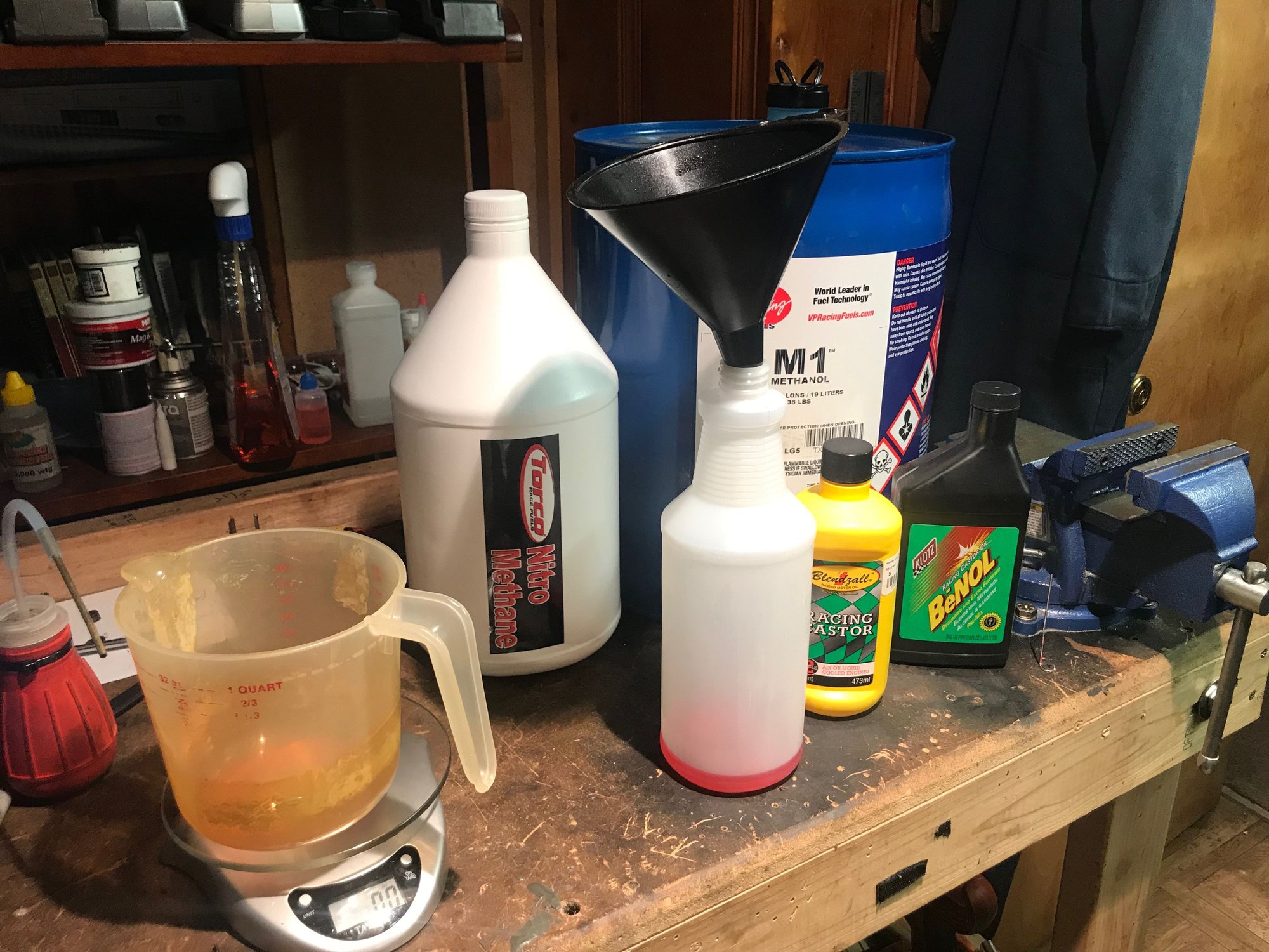

Okay guys, I did some experimenting and discovered that Maxima MK2 will NOT work at all with methanol and nitromethane, and I'm not a big fan of the 927 either. However, the BlendZall is very good stuff and so is the Klotz (BeNol and Super Techniplate) oils. I also used Torco Nitromethane and VP M1 Methanol. I mixed up four quarts (25% with 11% oil, 35% with 10% oil, 45% with 9% oil and 55% with 8% oil), and the engines love the blends. The smell isn't bad either. Prior to this batch of fuel(s), I was using a local Nitromethane and Morgan Castor but, I can no longer get the local Nitro and I will no longer be using the Morgan castor oil. I mostly drag race, so that explains the high Nitro percentages. I have found that BlendZall isn't listed a lot from guys making their own fuel but it's "very good stuff" and I used a 60/40 of BeNol/BlendZall. Oh wow!! I had no ideal the pictures would be that large. Sorry guys.

My method may be different from your method. However, I use percentages and weight (volume). I mixed quarts (32 ounces) and to be as accurate as possible I use the weight method. As my ancestors would say; "there's more than one way to skin a cat." I have all my fuels recorded (hard copy) and all I do is follow my program. It has worked for me since the mid 80s. He's a picture of two of my fuels.
