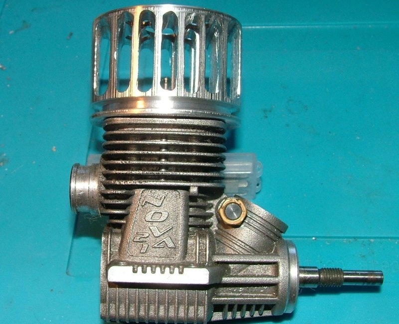

For a time I wanted to make a cooling head which looks different than all is used. I loved the old Mega P5 head and was thinking of such. After some thinking I came to this:

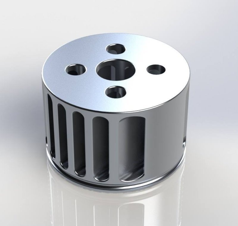

A friend made a 3D CAD drawing.

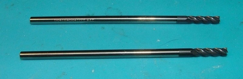

It looked that good I wanted to make it and bought some cheap long 4mm mill bits from Aliexroess

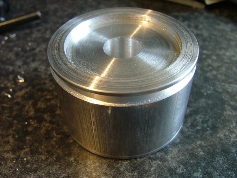

First on the lathe the base of the head.

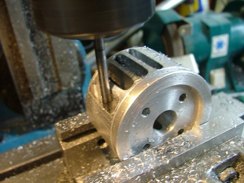

Then the mounting holes
I needed to mount a 2nd ruler on my mill to hold on the right movement, so far the start of the 1st slot.
A few slots ahead the shape became vey visable

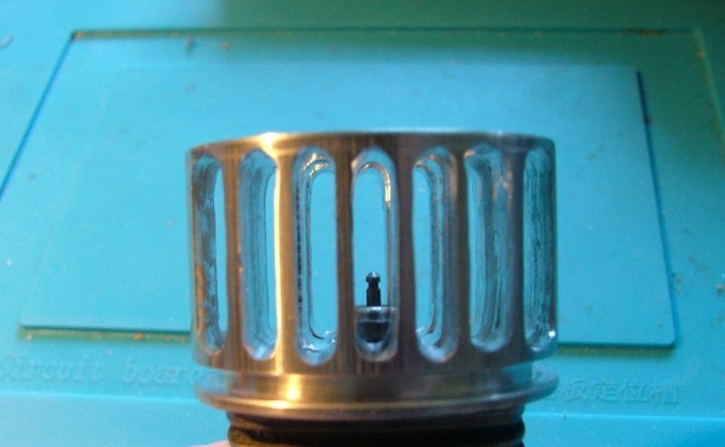

Not bad for a 1st try

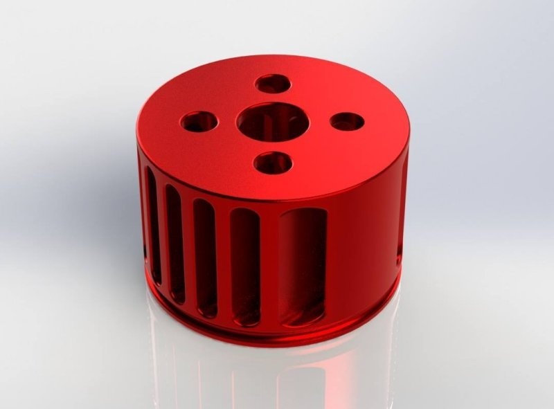

Meanwhile with a file I made some edges and surfaces much better looking and now it is time to polish it and give it a color. I want to have it red but some say it must be black.
This is a CAD drawing with the red color.
I want to try a 2nd one but then the slots must be done on a CNC mill for a better result.

With normal heads the fins get the heat by a tree construction over de center of the head. My head has each fin directly connected to the base so I think all 8 fins will work the same to get the heat out of the head. Also the slots prevents that all trapped air can bend off from the head and so the air is forced to flow through the head.
The test will be to tune the engine with a normal head and then place this one to see if the engine reacts the same and measure the temps to compare.
But most of all I wanted something unique and I think this is it.

Forgot to mention, the weight is 62 gram, about the same weight as an original head, that means it has the same amount of material.
