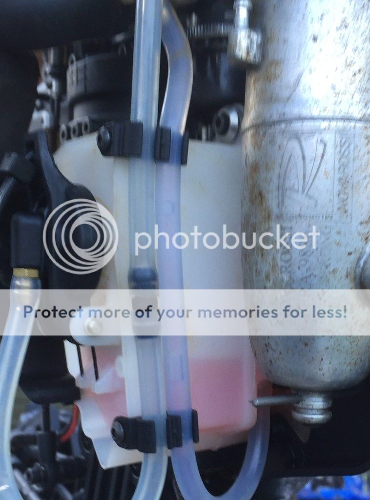

Well as a final wrap up of the first event with the new THE NITRO SHOP modified REDS R5RACER engine, Neal sent it to me after alot of R & D using his dyno and the engine is simply amazing, it has the best and most solid idle i have seen in my time as a racer, the return to idle is direct and the idle just idles away with an extremely low idle gap ( set at 0.35mm ) I choose to run the engine during the 2 practice heats for the event with the 8.5mm venturi and the novarossi 41001 header & novarossi 9886 pipe as directed by Neal, this combo was fantastic and i was doing a roll out lap ( 35 seconds ) and the 12 laps in 7:20, plus the extra cut away lap to return to the pits, giving me about 8:20 of run time, the picture below was what was left in the tank.

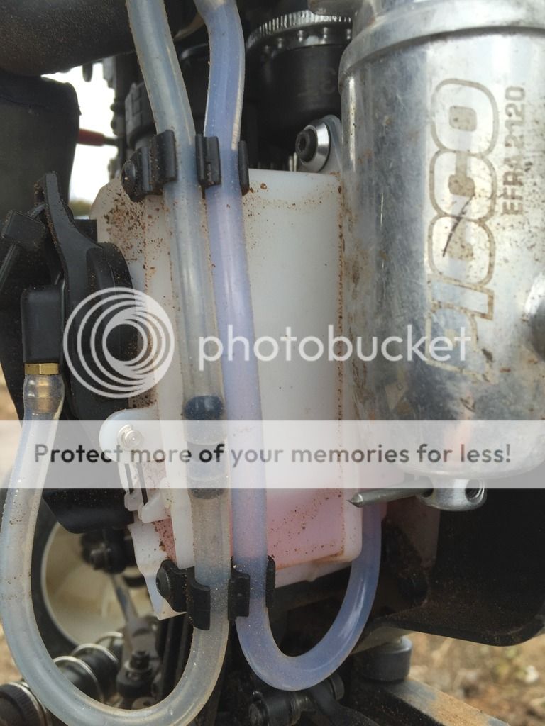

Once the practice round was over i needed to swap out the Novarossi 9886 pipe as it is not on our approved pipe list for racing sactioned events here in Australia, so i installed the Picco 2120 pipe with the rounded Picco header, the tune and 8.5mm venturi stayed in place as i went into the qualifying rounds, again the engine was fantastic, Neal asked did i feel any change with the pipe swap and i must say that i felt no real difference on the track and my lap times did not change at all, same track, same tekno truggy, same grip level, same outside temps, same tyre combo just about an hour apart.
I thought that the 9886 2 camber pipe would have used more fuel and the picco pipe would have been better on fuel but as this picture shows, i again did a roll out lap ( 35 seconds ) then had a 12 lap 7:22, plus the extra cut away lap as i returned to the pits, the engine temped at 221f on the picco and at 218f on the novarossi pipe, here is the picutre of the picco tank after the qualifying round.
I would not have believed that the 9886 & 41001 combo would have been better on fuel but it was, the 9886 combo sounds like it is angry via the note coming from the pipe but lap times is what every racer is looking for and not the best sounding engine combo, you can clearly see that there is an easy 3 minutes of fuel left in each tank, so to those guys needing more proof all i can suggest is buying this engine & pipe combos and run your own back to back testing.

Where's the peanut gallery on this one !!! 9886 gets better mileage then the EFFRA Approved Picco 2021 ! 2 chamber pipe getting better mileage then a 3 chamber pipe ! there is proof right there back to back test in race conditions !
In the end its all about efficiency and giving the engine what it needs to operate efficiently, I do not believe the common practice of choking the engine back with small carb insert and a restrictive tuned pipe is the best way to get good mileage.... Its a great way to kill off some of the engines power if that's what your after but if anything it reduces operating efficiency..
