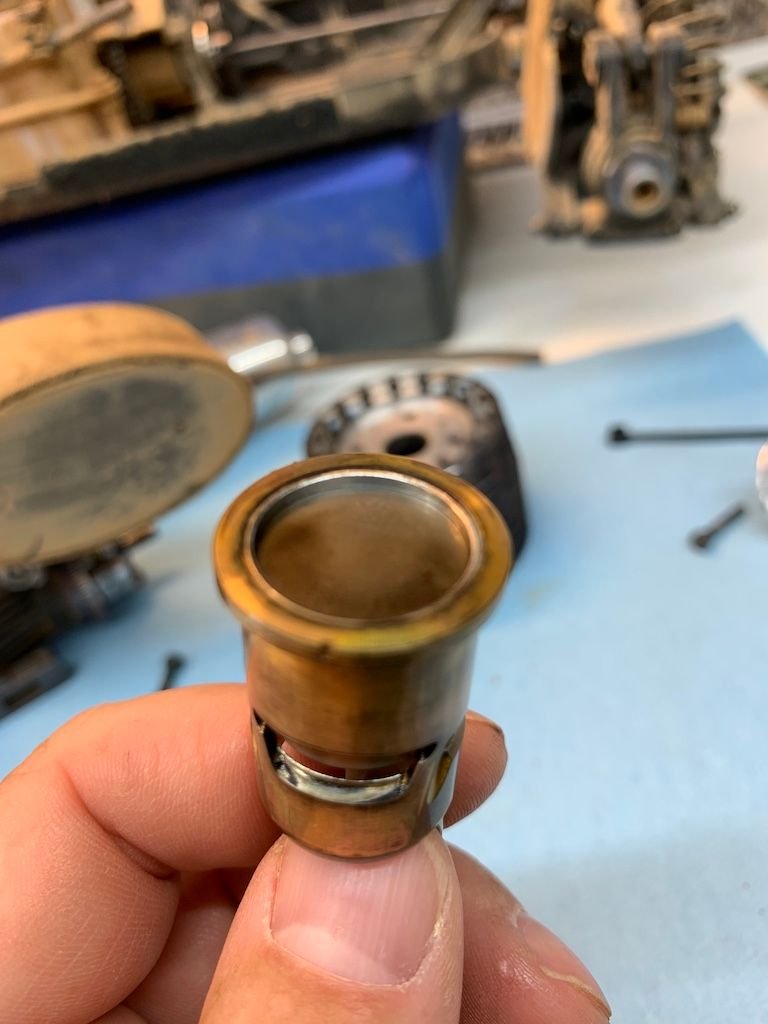

Thanks for that input, I certainly don't want to destroy the motor. I think I am going to send it out to RayA for a pinch. I got this motor used from a buddy (yeah I know) and it supposedly only had a couple gallons on it. I trust him and think that many I had it tuned a little lean cause I have only put about a half gallon on it and I just can't get it to run right. I seems to be good until it gets to the end of the first tank (fully heat soaked) then it just wants to flame out. I have reset needles to factory, replaced plugs, replaced the tank and lines, rebuilt the clutch and I just can't get it to act right. At room temp I could turn it over with the plug in fairly easy so I torn it down. In the pic I have attached I was able to push the piston up to that point with barely any resistance. If I push a little harder I can almost get it to the top.

Yea that’s a bit worn. The rebuild kits aren’t that bad as far as pricing. You can order through tower hobbies an get a pretty good discount if amain doesn’t have a good one currently. The repinch is great to extend life of engines for sure an should get you another 2-4 gallons pretty easy if the set are able to be pinched. I just rebuilt a protek V2 an broke it in again for a friend of mine. He has two of the same engines. One never made it past the first race. Both broken in the same exact way. I’m almost positive it was just a badly matched piston an sleeve. The rebuild is running very very strong at a couple gallons now. New front bearings an air filters are truly the life of any nitro engine. It’s a pain for sure but well worth that extra effort.
