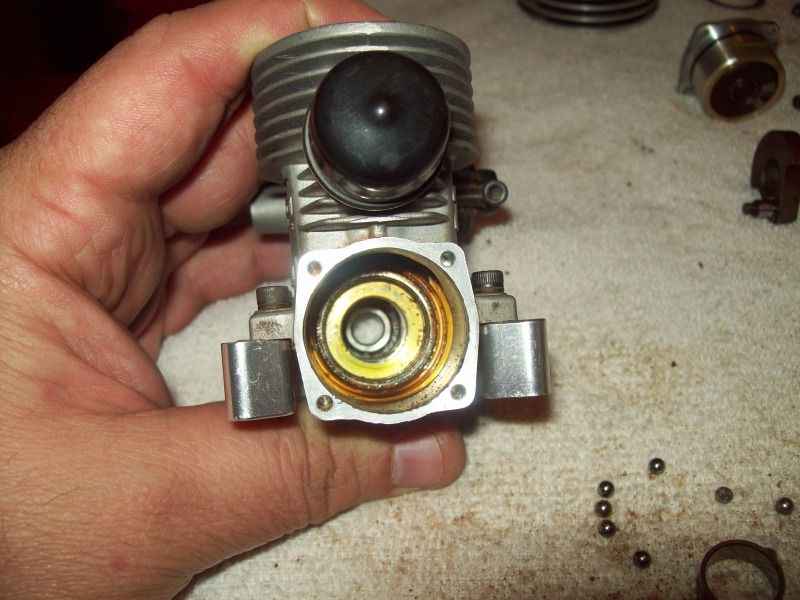

Yea, I'm gonna get those tools....and I finally got it off with a heat gun....
I found out what happened....the crank bearing blew, sending chunks of the shield through the engine and ceasing it up.....2 of the balls were missing and one looks like it got smashed....WOW....now I can't get the outer race of the bearing out of the engine....LOL....That thing is in there good!!....
Any ideas?

Holy cow! That thing looks like it was sitting in the yard for a couple years lol.

Naa...it's just dirty -- That's not rust, even though it looks like it, it's fresh track dirt....LOL.....
Any ideas?
http://youtu.be/TuzEco3EDUM?t=6m46s
Heat and bang... just like this video. Should fall out.

If just the outer race is left, u can use heat and very carefully tap it out from the other side. I don't think I've ever seen one do that. That looks bad

ok you got the flywheel off , now heat up your oven say 350-400f be sure to take out your carb etc and just have the case only leave it in there for about 20 mins or so or you could do direct heat with a heat gun get it very hot use some oven mits etc so you dont burn yourself and find a wooden table or something like that and simply hit the case on the back and hopefully the bearing should fall out or you could tap it out from the front be sure not to score the case

I'm still trying....tried it twice so far with my heat gun--maybe it's not hot enough yet....it's still stuck, I'll give a few more tries during the week....Thanks for all the info guys...I really appreciate it....
