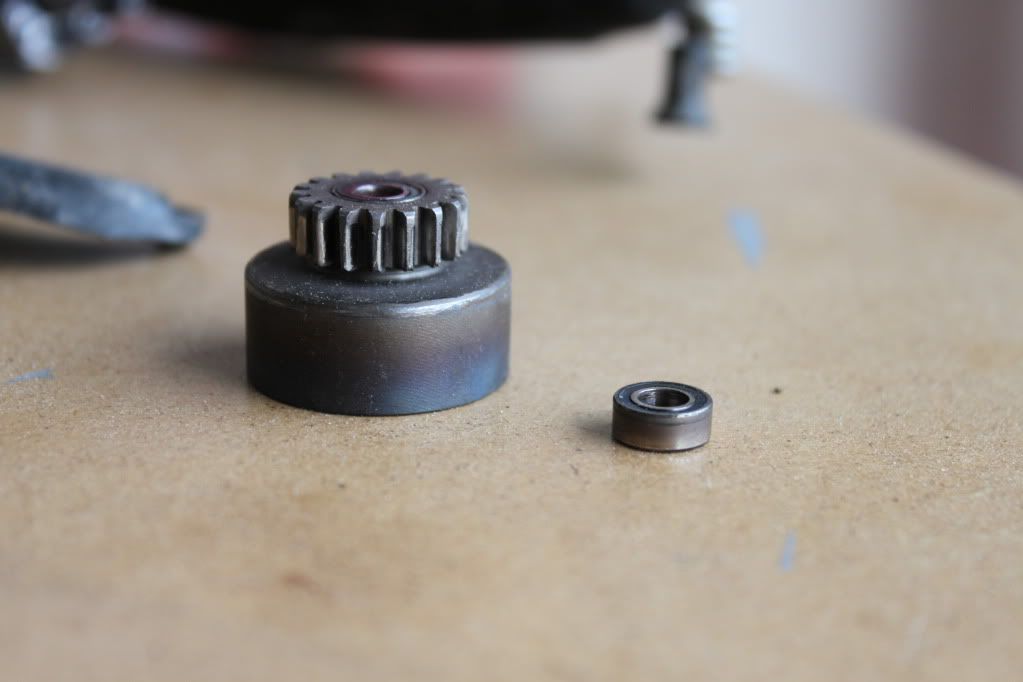

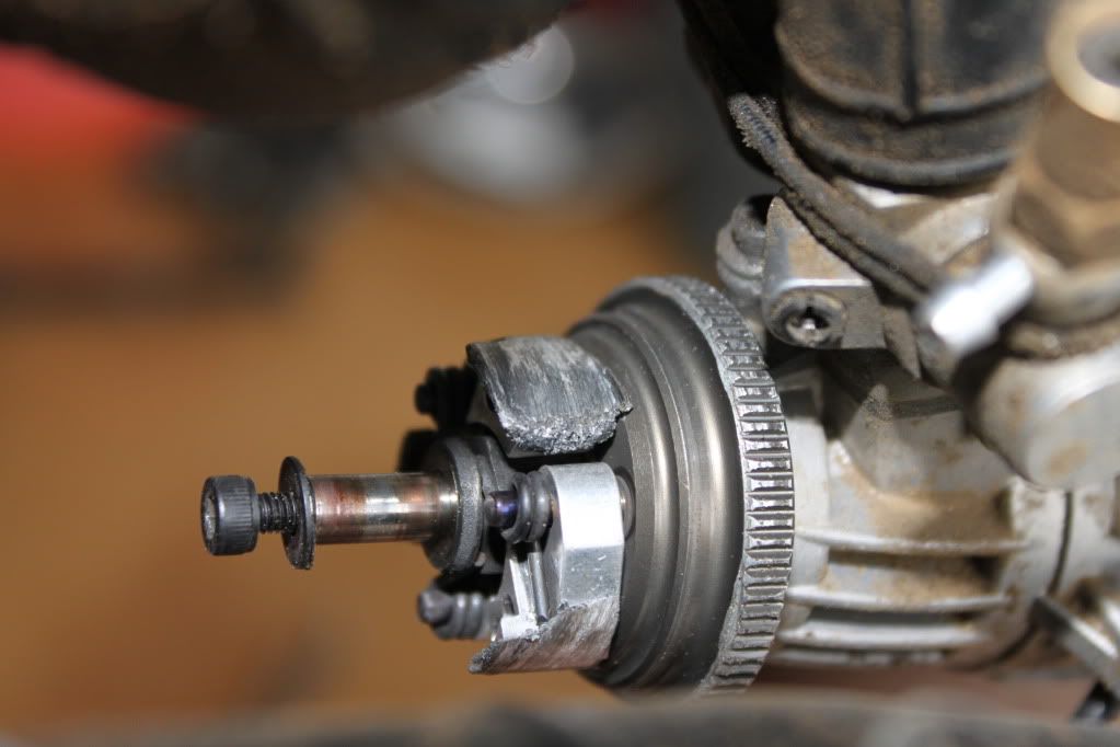

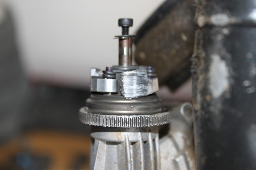

found the problem, HA. I have put over 1/2 gallon on the car since I got it. I was expecting to make some repairs, so I thought I'd just drive it for a bit then tear it down. I honestly dont know if it was like this when I got it or if I did this.
im just glad it was easy to find
