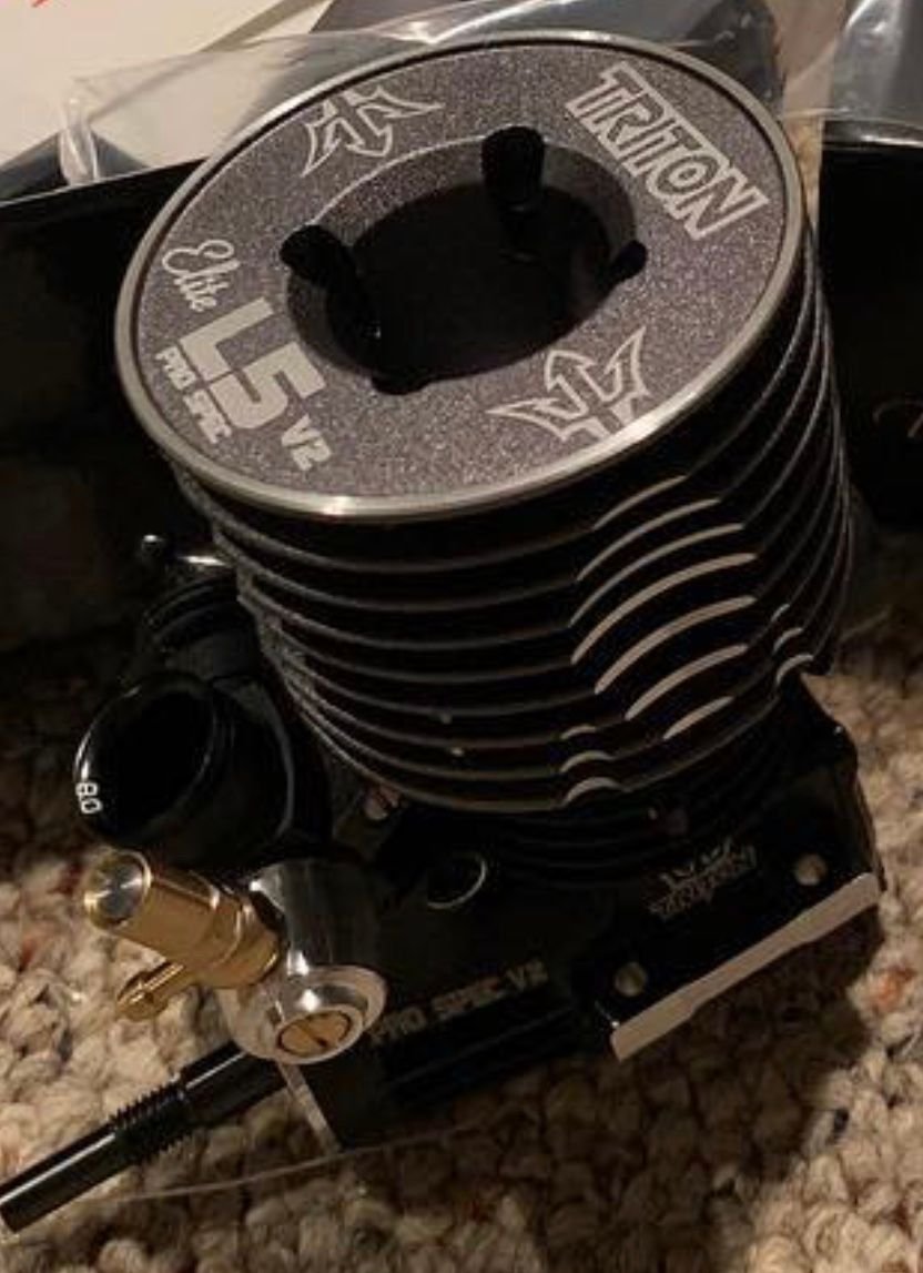

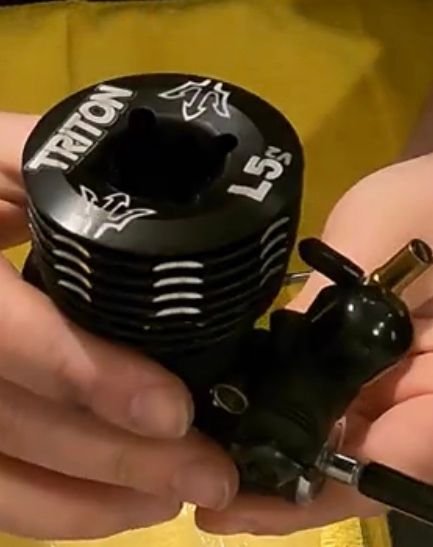

which L5v2 is it though there is 2 different ones.
L5v2 elite with silver grayish head that was picco based.
L5v2 black edition that is black head. Which is Lm factory based.
both are completely different engines.
he doesnít sell the picco factory engines anymore.
Maybe you have a black edition Lm factory one? Take a look at photos below to see which one you have.
if you have a L5v2 black edition engine with black head then itís Lm factory. Some werks orion performa sirio head buttons might fit.
if you have a L5v2 elite then those are older piccos. Maybe picco boost engine head buttons would work.
Triton L5v2 elite picco factory engine.
Triton L5v2 black edition. This is Lm factory.
