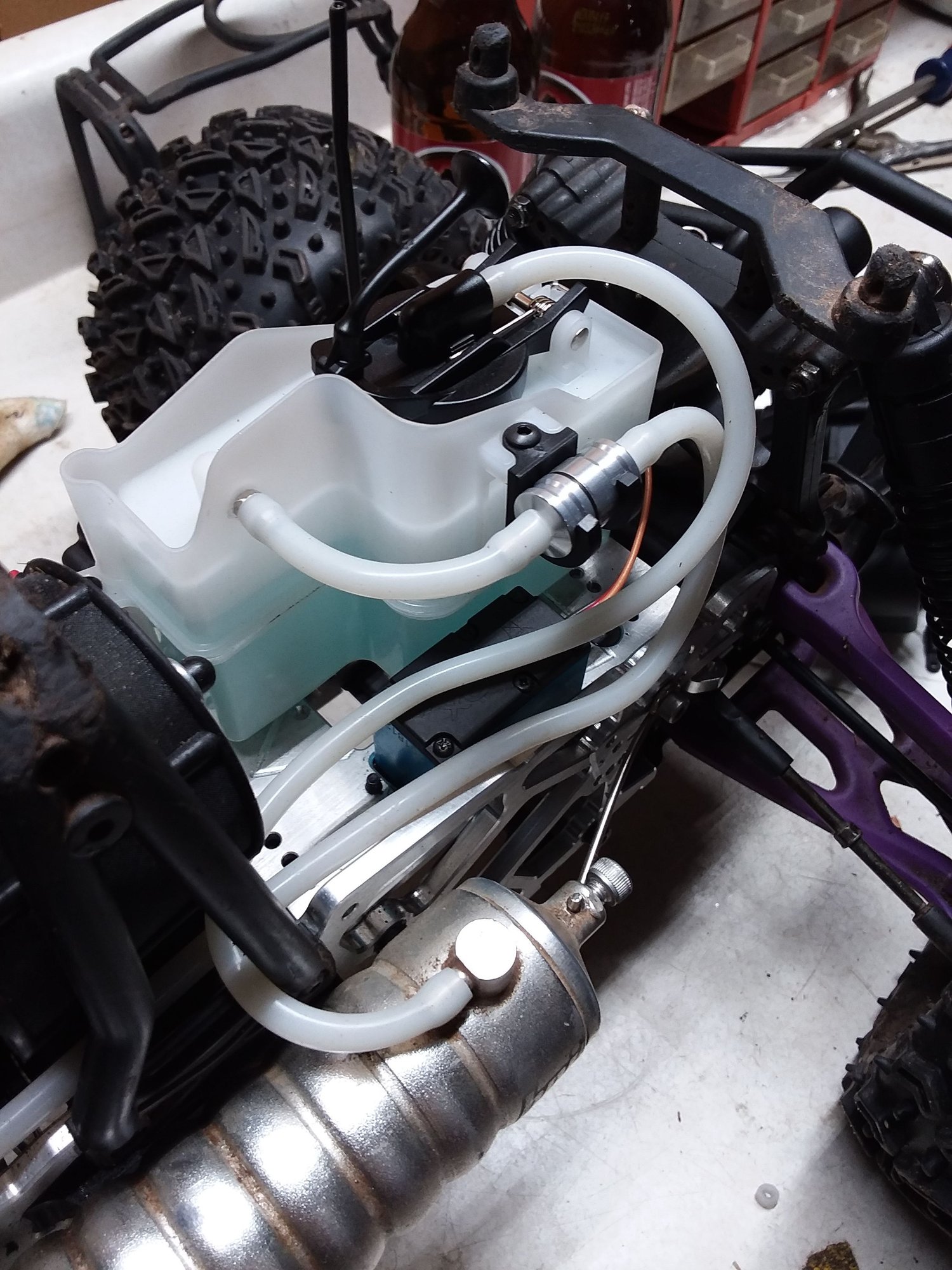

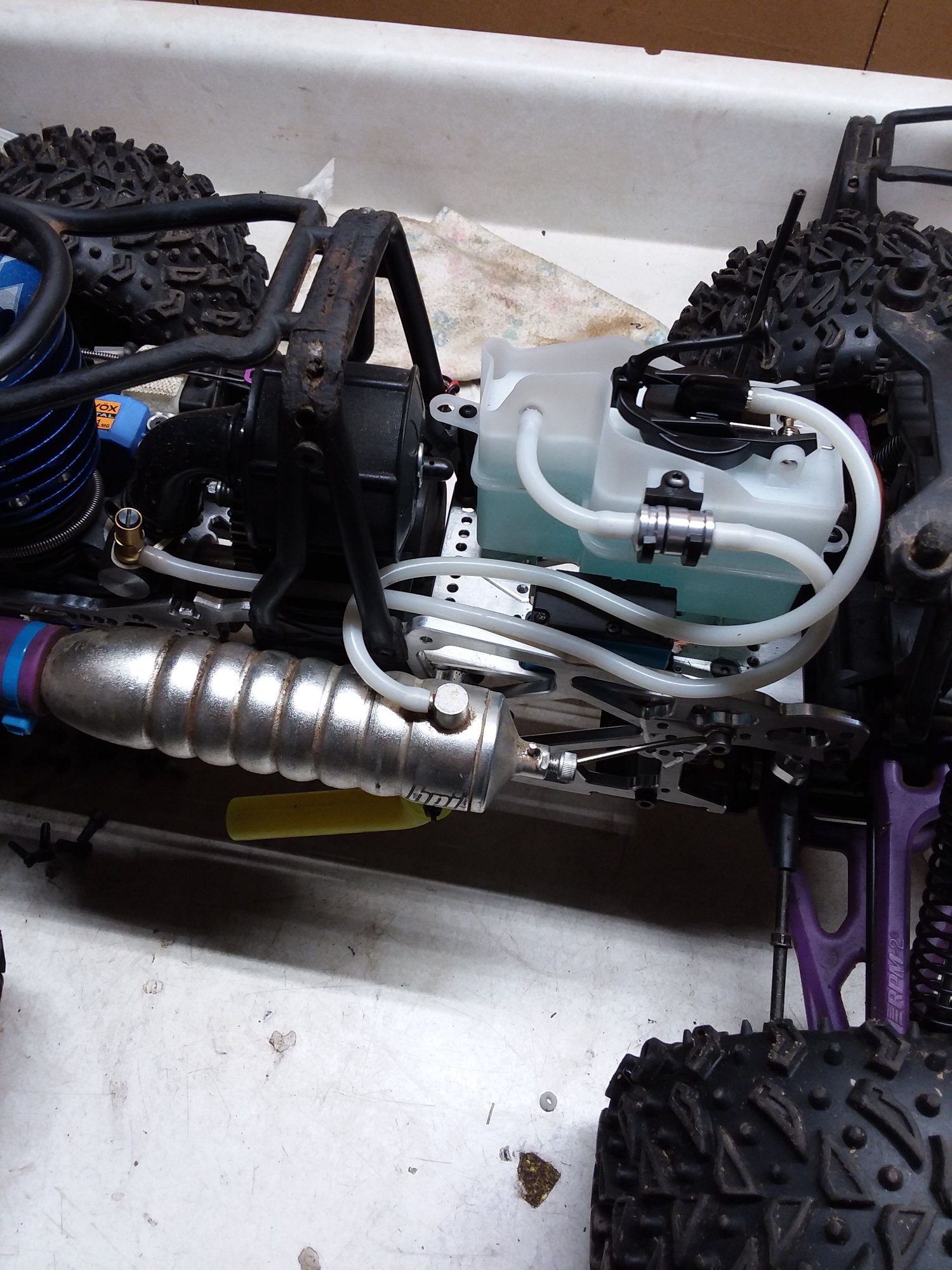

So what do I do then? How do I get this to work? How do other people get it to work? I know I've built a mid tank savage before with this same setup and never had this problem....There has to be something Im just drawing a blank on....anyway heres some pics of what Im working with

Looking at that high speed needle is the first thing i think you need to try. Lean out the engine some. Changing tanks and stuff can affect the tune. Leaning that hsn will fix the issue that is like the master flow valve in reality for the engine. Close it far enough and it will not let any fuel into the engine.

That thing in the pressure linr, is that just a filter or is it a oneway valve?

Nothing on the pressure side. Caught me off guard as well lol.

It is a brand new engine at stock needle settings. I figured leaning out the hsn before even breaking it in would be a bad idea.....and yeah that is a filter and its on the fuel line, nothing on the pressure line
