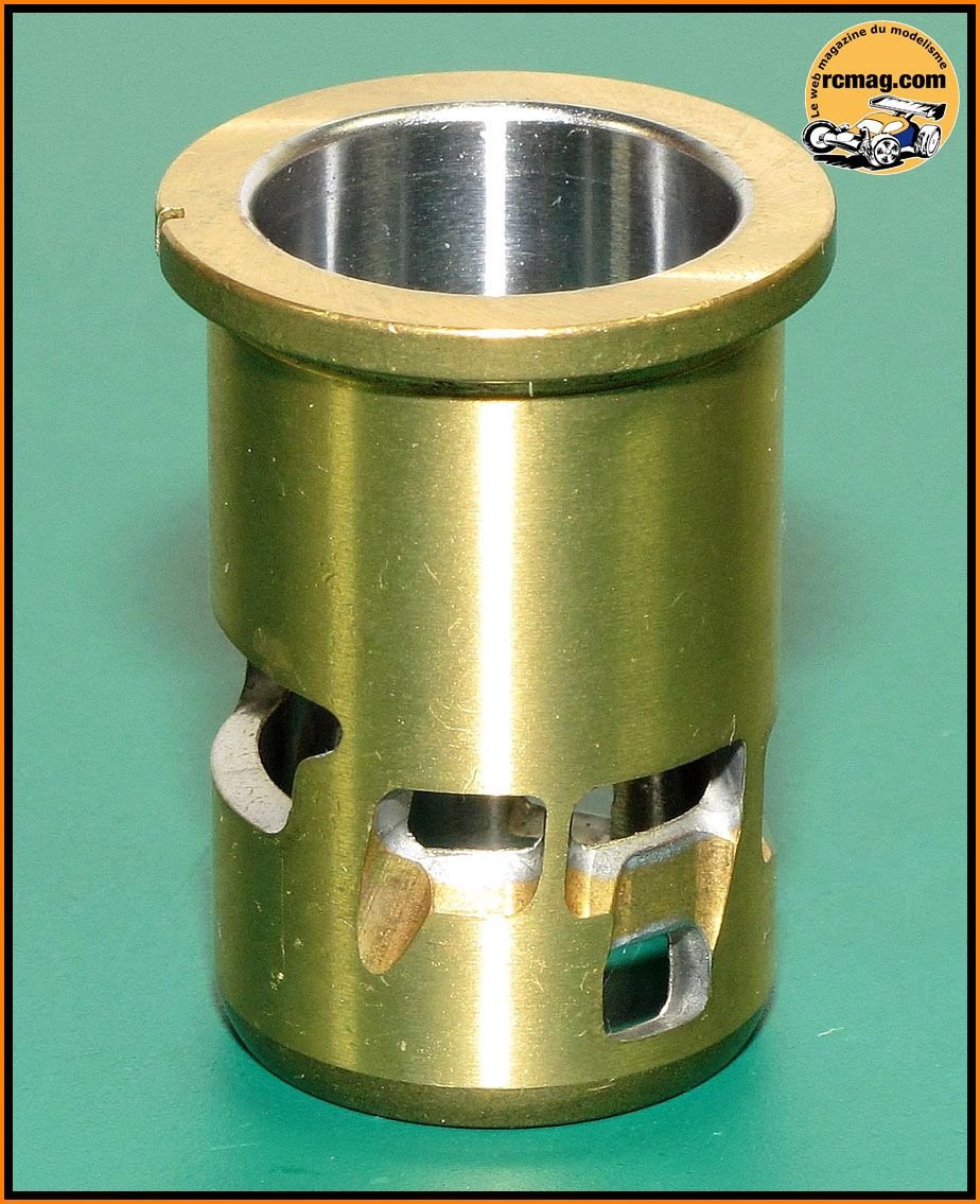

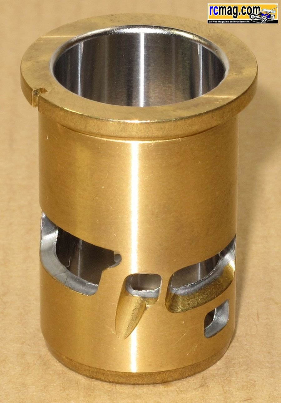

Hi guys,
I recently acquired two Force E21-R26 engines. They are basically as same as RB Killer 10 & Ofna JL. There is one difference however, the bypass ports on the sleeve are merged with the transfer ports on Force but separate on RB & Ofna (see the picture below, interesting design tbh). Anyways, I've been getting a lot of headaches trying to dial this engine in. When you let the engine idle for 15 seconds it immediately starts to load up and I believe unburnt fuel/oil tries to enter combustion chamber from the bypass port and engine either stalls or starts popping violently causing glow plugs to foul. When I examine the glow plugs, I see that the thin wire gets broken due to added pressure during combustion after load up (only a very small break). I tried different carbs (picco carbs fit just fine) with smaller & larger venturis and although it seemed to help but did not solve the issue. I tried leaning the LSN but it gets to a point that engine starts bogging immediately due to very lean LSN. I tried OS P3 & Odonnel 77T & 97T plugs and the results were the same. It's also important to note that engine comes with three 0.2mm underhead shims whereas RB Killer comes with four. Compression might be too much during the load up (might need to add another 0.2 to decrease the pressure)
I read all the Ofna .21 JL thread along with RB Concept Engines thread and only found somewhat similar issues but no ones has talked about this specific issue.
The question is, is the sleeve design causing this issue? Or is there something else I need to look into.
It got to a point that it started to aggrevate my OCD and I need to solve this.
Force E21-R26 Sleeve
RB Concept Killer 10 Sleeve
Appreciate the help

No, the sleeve design on the bypass port is not causing this. It seems a combination of fuel, plug and compression. Or it is just a wrong tuning.

The bypas is nothing more than a shortcut of the fuel flow into the transfer ports, it still comes from the same source as the normal flow so with or w/o there is no difference.
