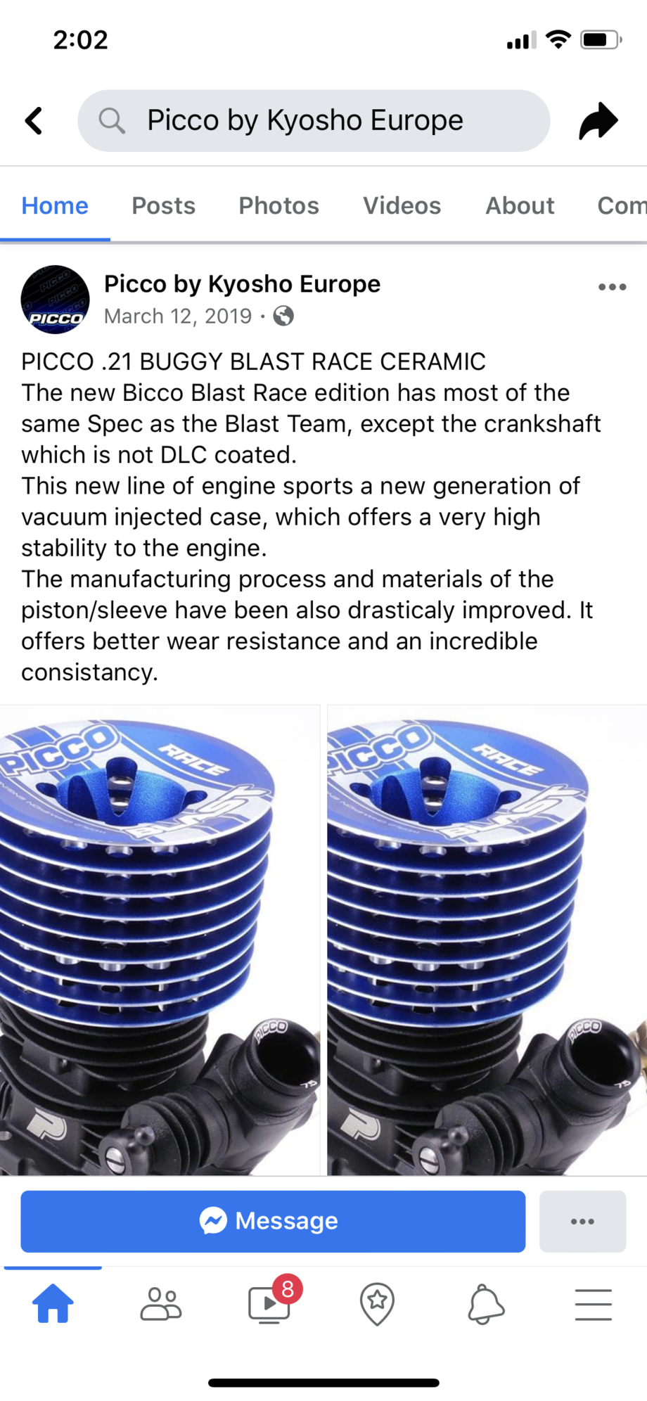

Crankcases are now made with a completely different method, P3X is a european version of the US "RACE" version and it's basically a cheaper version without DLC crankshaft and steel bearings

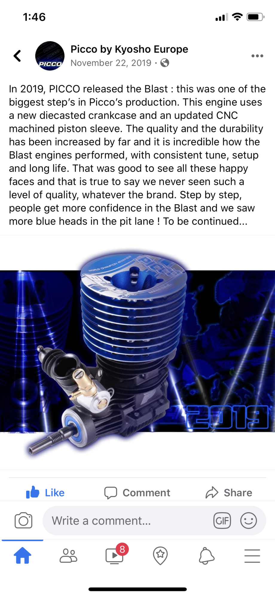

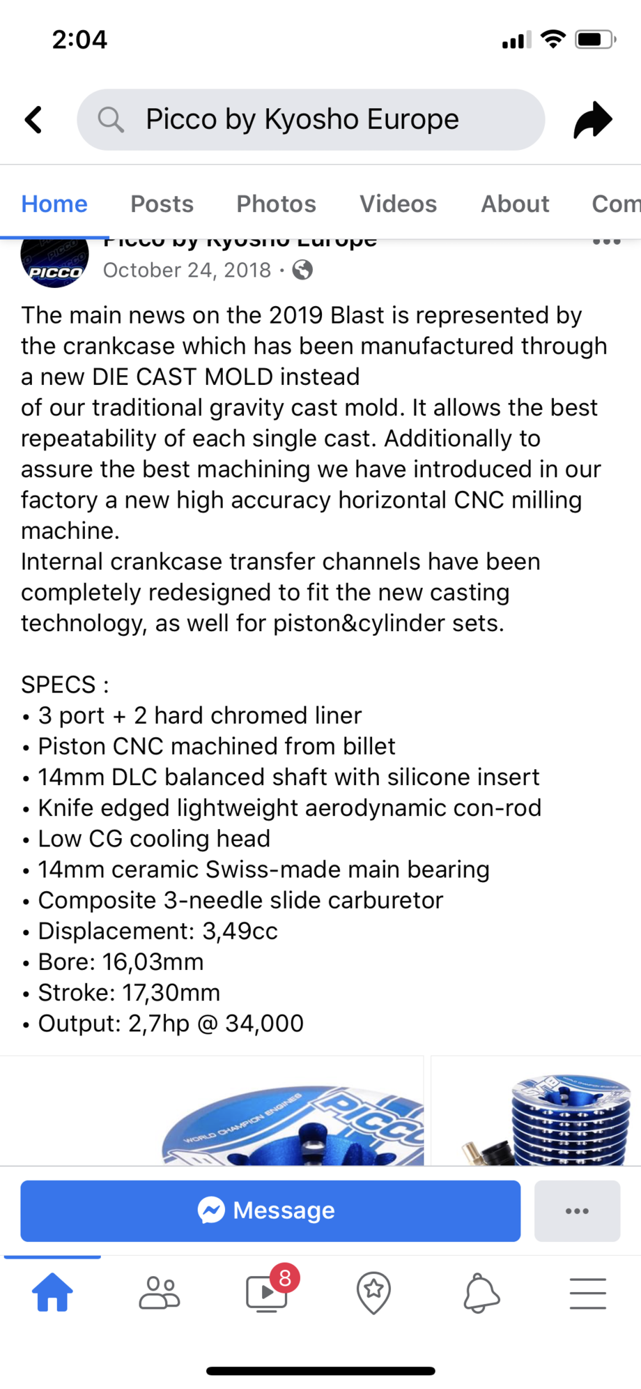

hey what’s up. So yea I found info that the blast case is what in different way now. See the below photos.
I see Reno said the blast dlc and the p3x dlc is the same engine?
But I look at parts explosion and noticed there is different part numbers? If there the same why is there different part numbers? Case piston sleeve head button and Maybe crank not sure on crank cause they don’t have the dlc p3x parts explosion posted yet it looks like. He said the p3x has been optimized for better price but it’s the same. Are the parts the same specs and just made differently or are they different cuts timing ports or something. I’m kinda confused. Was there a issue with the blast parts and they changed them? Trying to figure it out. If you can let me know that would be great. Thanks!

After looking at the video Reno posted and looking at the picco america site, it looks like the same motor in regards to parts. I think the BLAST is the US version and Europe gets the P3X DLC. Thats why you see Kyosho Europe releasing the news.

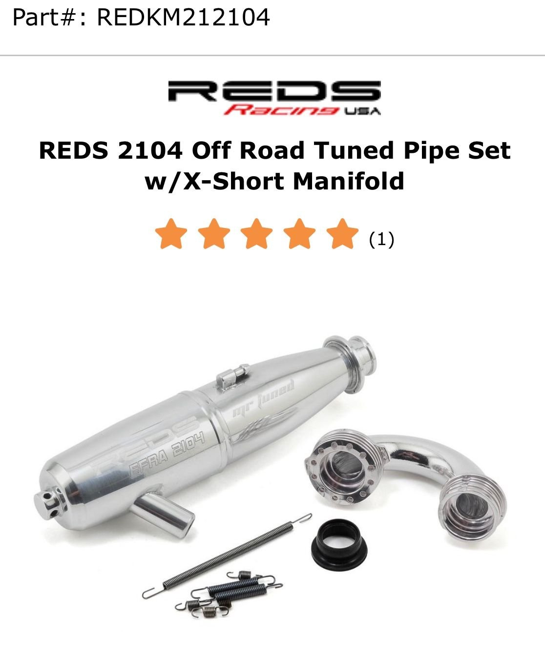

So I ran my Blast the past weekend. Feels similar to my V1 with similar mileage. I get 9:30 a tank using a Reds 2104 with medium header. When I ran the V1 with the Picco 2133 it got like 7:30 but it made gobs of power...too much. Only useful on high traction indoor type tracks.. I expect the same with the Blast. The V1 with the 2104 also got crazy mileage...maybe even better but it was also using a 7mm restricter vs the 7.5 in the Blast.

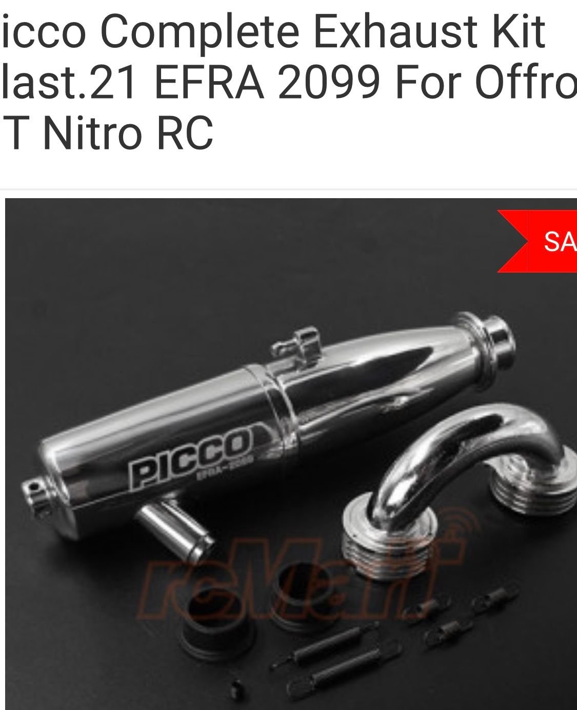

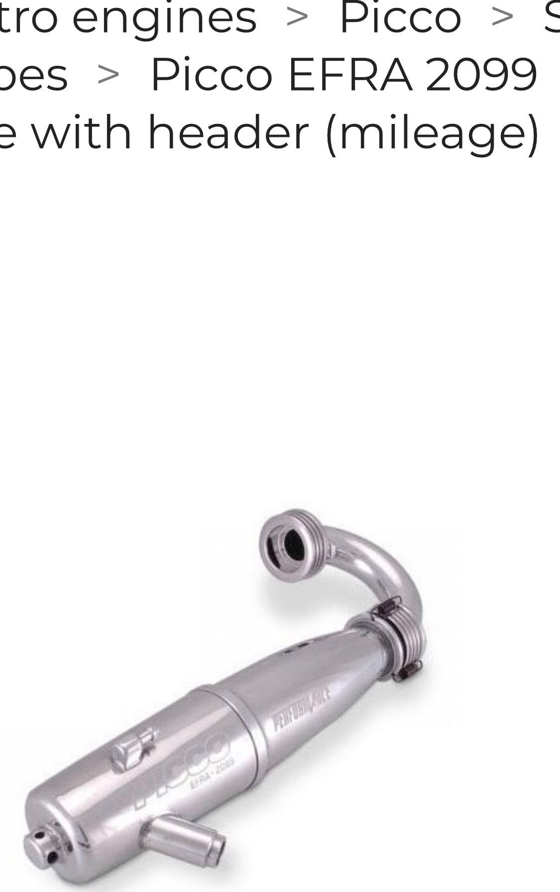

Correct me if i'm wrong but i believe the Picco 2099 is super similar to the Reds 2104. I've seen 2 version of the 2099. One looks short with a flat end and a really far forward nipple and ive seen another version that looks exactly like a Reds 2104 that says Picco on it. Was it revised?

yea there’s 2 2099 with 2 different nipple styles. Yea the 2099 is soft bottom end pipe and not as much power overall. 2133 has way more overall power.
2099 is kinda like a os 2060 by looks. 2099 looks like that reds to. It also looks like hipex 2108.
