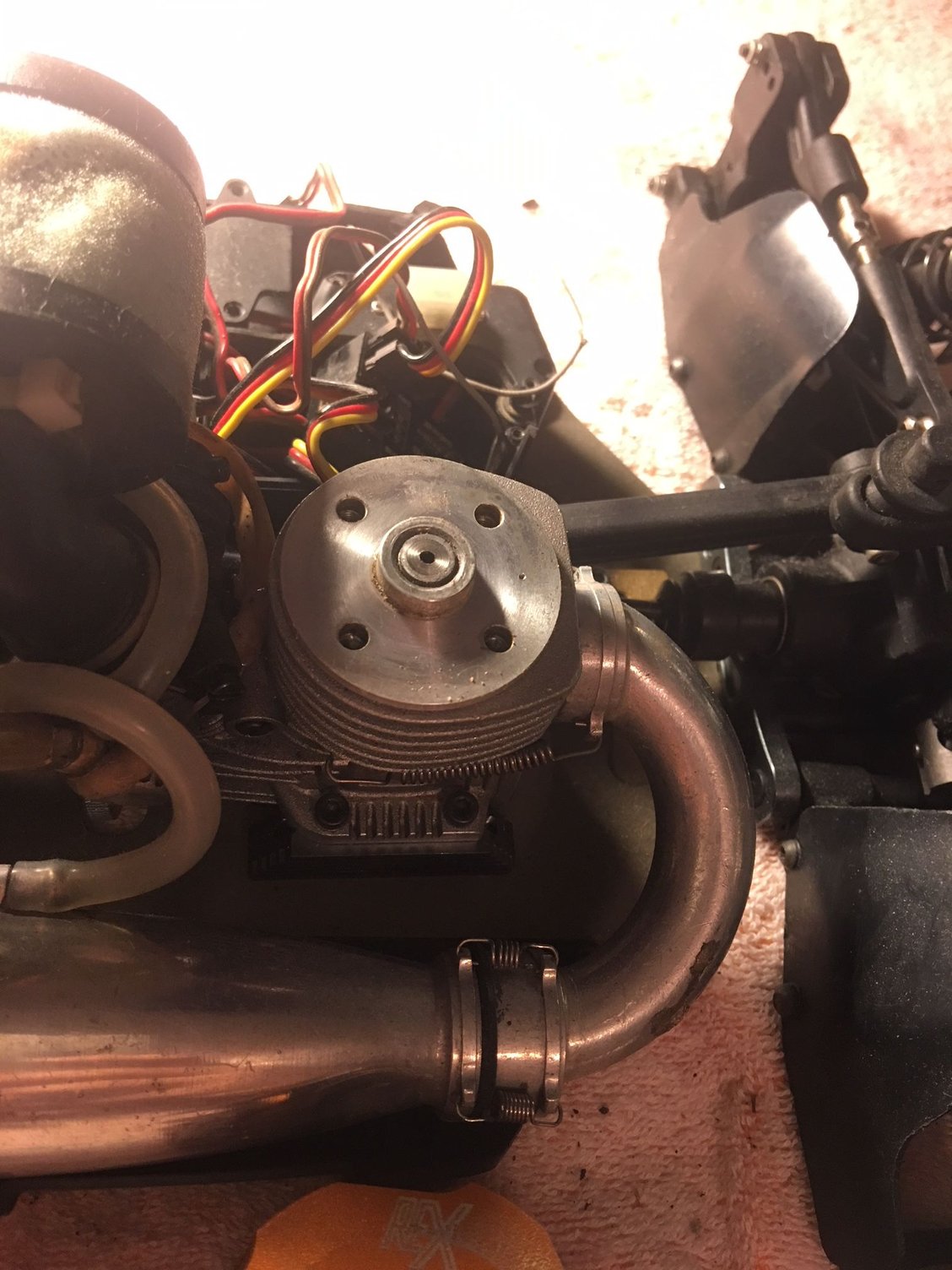

Alright guys, got a new button and seems this one sits higher than the other Nova button. Part # for the new one is FU-28002, it's engraved with Nova brand so it's a little different, has a hump where shims would go and comes with only one spacer instead of 2 like the default Paloma.
One shim is in there now, screws are torqued down and as you can see there is a bit of spacing. Should I concern myself with this and try to remove the shim or should it be fine as it? Thanks

Use a dremel to make a slot and try to unscrew it with a large screwdriver,
Or else get a new buttonhead....
Yes, exactly what I was going to do. First and last time I'll ask my buddy to "twist that in snug for me".
Edit: Just in case, do you by chance know of a part # or something to find a button to fit the Rex Paloma. Thanks

you need a left hand extractor bit. will cost you a couple dollars and it will take it right out.
Sweet, going to check out my drill and see if I got any. Do you know what size? thanks man

pretty sure you need 28011 or 28021 head button ..... engine will not run properly if at all with that head button
Yup, you're right. I'm livid at this point, going to buy your 7 port tomorrow with breakin and modding, I'm over it. It's going in my buggy, I am going to email you tomorrow about an inquiry I have once I find your contact info.

did someone tell you that was the right head button to purchase?
Yes, was told to get the 28002. When I purchased it, I was heading out the door for work so didn't do research on it just assumed he was correct. A waste of $25 and a week of waiting, kind of annoying. If you don't mind me asking here, what is the average time frame for your modding and break-in for your 7 port? I want to go through with it for my buggy, guess I throw something bigger in my Truggy.
